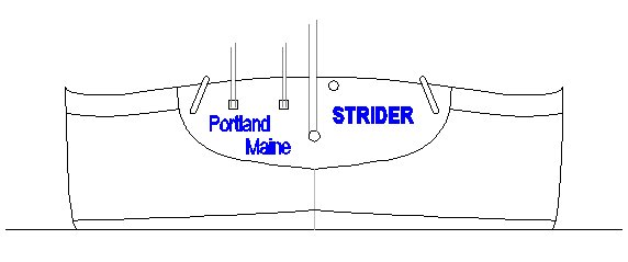

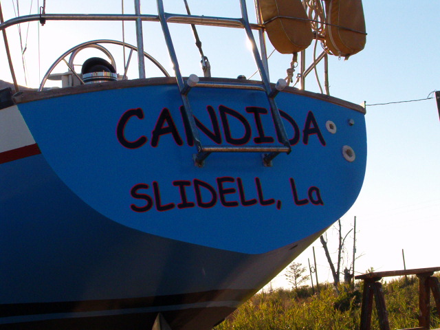

Gee. I guess that, if I lived in Louisiana, I would have to yield on my preference for not using a state abbrieviation.
Tell me though, does that "a" count as a 4 inch letter? :)

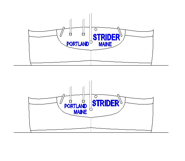

That does bring up another question. Type faces are referred to by the size of their capitals. I wonder if I could get away with this:
Tim R.
May 27, 2004
3,626
Looks good to me Roger. I think you are being way more fussy than the CG would. All of my letternig is based on captial letters.

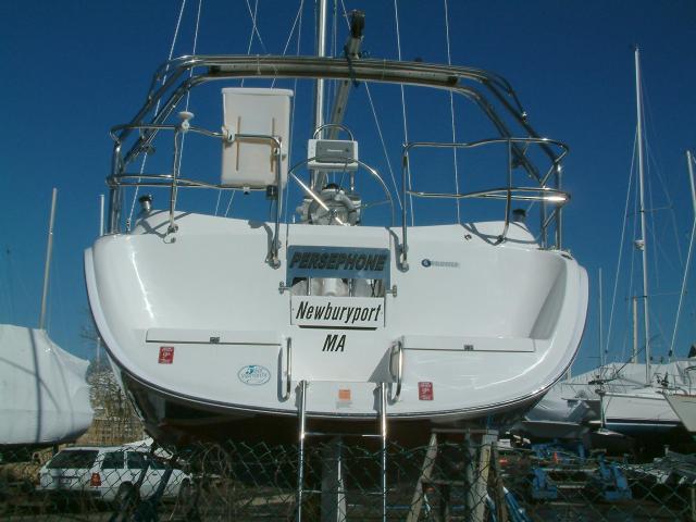

Roger -
Unlike you I have a large stern, but to avoid ugly (in my opinion) placement I had to fit my lettering in spaces with just barely sufficient height, and width that standard typefaces wouldn't fit.
The solution was to have the lettering decal shop's draftsman use their CAD system to "Kern" the lettering by keeping constant (legal) height and shrinking width.
This intentional distortion plus creativity in mixing upper and lower case letters yielded the result in the attached photo.

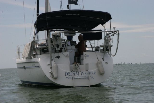

Nice to have a wide....uuuhhhh... transom! Plenty space except when I saw this picture, I realized that I didn't have the state, even abbreviated.. OOPS .. It will be placed just below the port name.. I promise, Chris.. :) It has been that way since '91 thru several Coastie inspections.. but you are right that is not an excuse for poor example..

Of course, you have an enormous billboard space...once you get over letting the boarding ladder dictate your choices. a little imagination, finesse and creative spacing will leave a lot of room to play with on such a transom. I'll try to dig up a photo of Commitment's derriere.

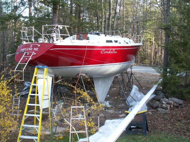

Here is a pic of mine Roger. I've been through several Coast Guard Inspections and had no problem with this. I'm not real certain, but I don't think the hailing port letters are up to the regulation, yet I have never had a problem with them like they are. Guess now that I've said something about it that I will.
After looking at your transom and your sketch, I see how you've very little room to work with.

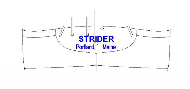

How about this?
I was looking at the transom today while heat gunning and scraping the old name off. I think now I'm going to just put the name on like the wind vane tower wasn't there. The name would have been partially obscured from the port quarter anyway and I like the traditional symmetry.
Name will be 4.5 inch letters full width, hailing port 4 inch with .75 inch width factor.
