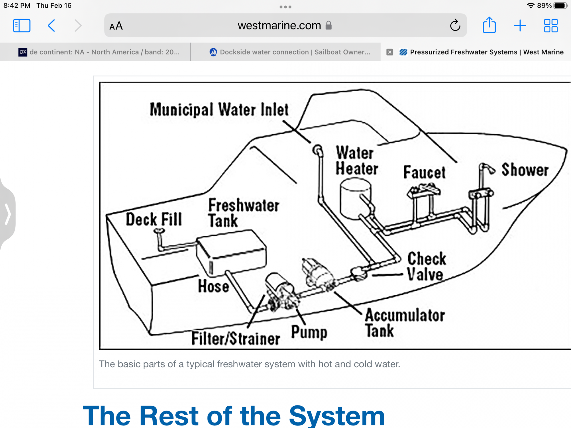

If you have a transom shower, just T it into the cold feed. Very simple
Art - how would that then feed back to the manifold for the rest of the system. No check valves anywhere? If so, you are correct, very simple. I believe that line is pretty easy to reach through the transom locker. If not that one, then the cold line for the shower. Would still need a check valve somewhere between the tank in the bow and the manifold.
It really is this simple.
The shower cold line is just a branch of the boat’s cold water system. The manifold is 2 way, with no check valves
The in-line pressure regulator you’ll need to install on the inlet has an integral check valve, so your water pressure pump can’t feed water back out.
So, the install is:
Mount dock water inlet fitting
Screw pressure regulator into it (it’s 3/4” hose)
Install hose to whale adapter on other side of regulator
Insert T into shower cold line
Pipe in..
you’re all good
So, the install is:
Pipe in..
you’re all good
that’s how most manufacturers install dock water supply when building the boat, including a backflow value on the pressure pump.
