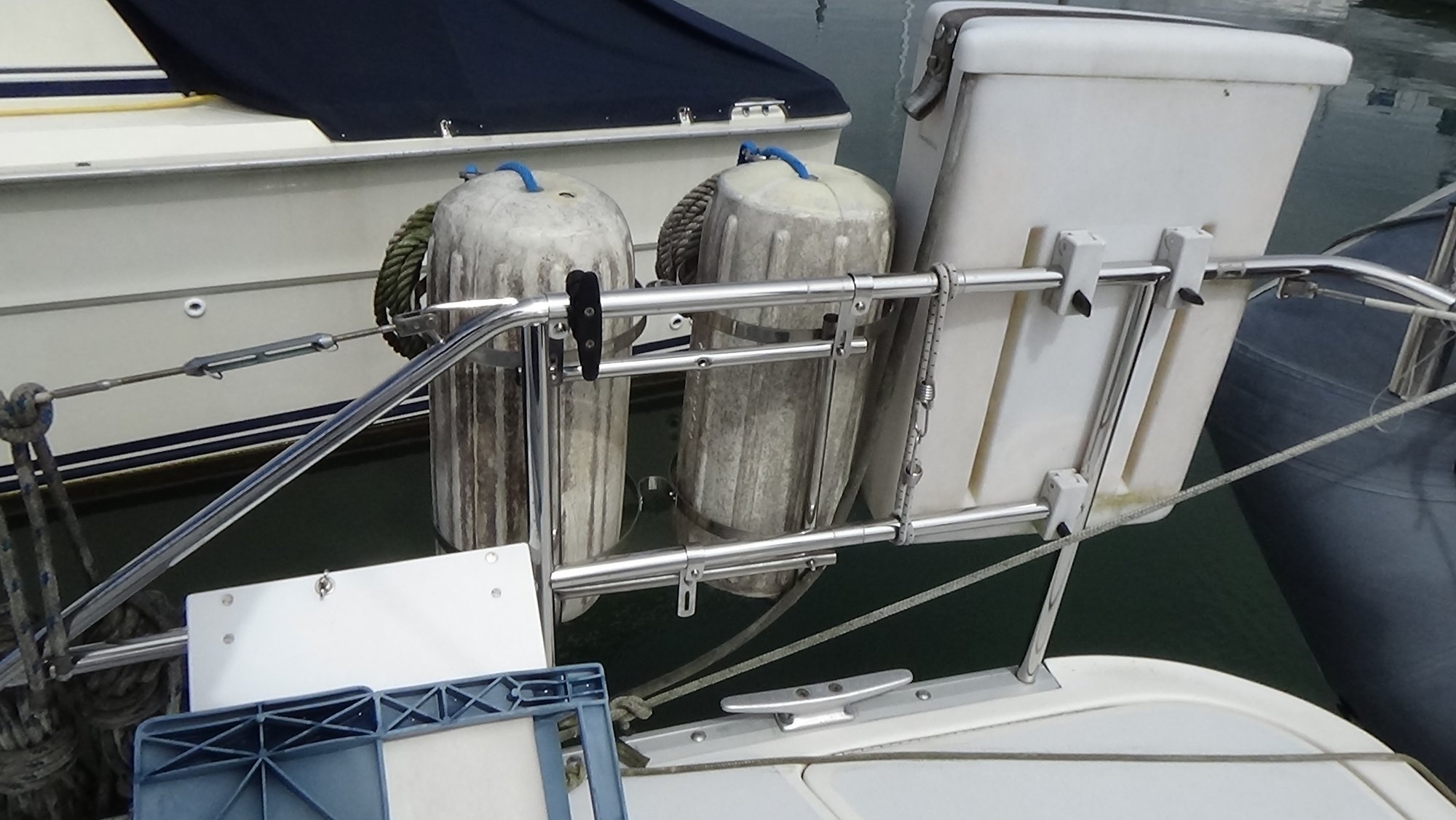

Two other points, Fred. Our boat has mid ship, as well as bow and stern cleats. I made two dock lines long enough to connect the bow/stern cleat to the dock cleat, then back to secure to the mid ship cleat as a spring line, bow and stern. Each line is the length of the boat, which works great.
I also installed dual Taylor Made fender baskets outboard on the stern rail port and starboard. Out of the way, convenient access and secure.
