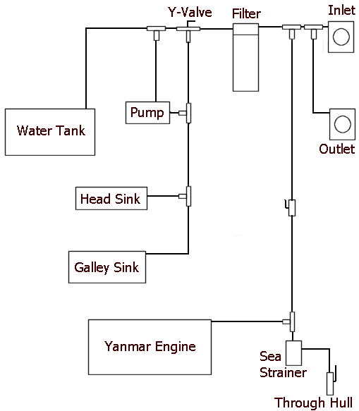

here is a diagram of what I did to my 78 hunter 33
I have a write up about it here
I have not hooked up the water tank yet because I am considering replacing the forward alum tank with 2 tanks (one under each lazarette in the salon).

actually, now that I think about it, the Y-valve is really a garden hose diverter valve (it has 2 ball valves in it) that allows me to shut off any water flow going back to the filter. So if it does cause back flow I have the ability to stop it.

Thanks for your reply. It looks like you gave your system a lot of thought. I merely replaced what was there with new pex. Anyway, I found out that the water fill has a built in one way valve, or backflow preventer. That takes care of water flowing back out when I turn on the pump. I will use a shut off at the pump just to isolate it from the incoming presure.
Thats for your imput. Your schematic helped a lot visualize how others tackle the same problems.
