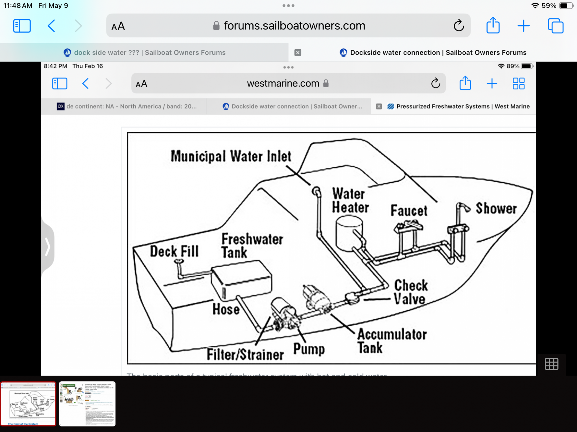

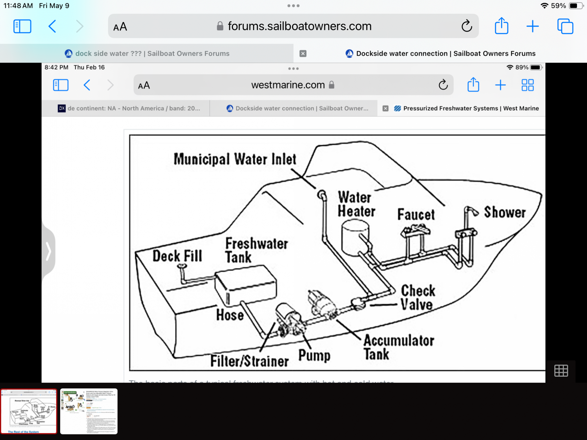

Pro/con arguments aside, virtually every boat, both power and sail, at our marina (excluding the small ones) has a dock water connection.
In answer to the question, check out the diagrams on the internet such as below paying attention to the pressure reducer one-way valve (at the point of connection to the boat) and water shutoff on shore when the boat is unattended. IMG_2629.png
You should not need a valve to select between shore water and tank water if done properly.
