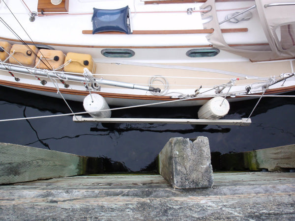

Depends on where you sail.
We often have to dock against very "rugged" industrial/government fish piers.
The pier doesn't float..the boat does.
The pier often has an uneven surface.. or you need to bridge the gap between 2 pilings.
Almost every sailboat here has them. (Unless they just dock in foo foo marinas)
Why would anyone buy a commercially made one ? It's a piece of spare lumber with old retired ropes attached. Basically free and can be made in 15 minutes.

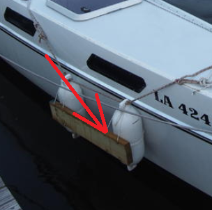

Made a set of fender "boards" with 3" schedule 80 PVC pipe & PVC endcaps. Light weight & easy to handle & store.

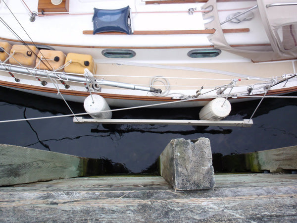

What's with all the diesel jugs?
I can only assume they contain fuel ? Hehe
Not my boat.
That said, where I sail there aren't many places to get fuel (or anything else) once you head north, so people often leave with full tanks and carry extra water and fuel on deck in jugs.
Similar to some people heading offshore but in smaller quantities
