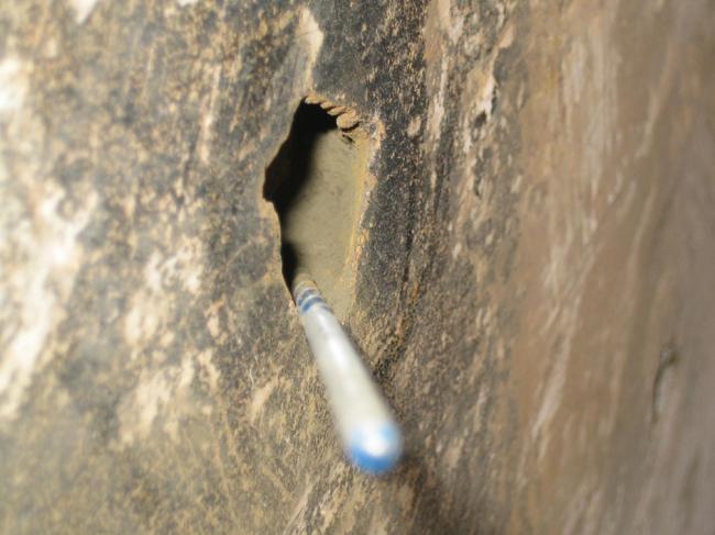

I am prepairing my vessel for a long trip. She is a Hunter Lengend 40, 1985.
I bought her in 2006. And when I was sanding the keel, I found some big holes in it. When I took out the antifoulling I found out some soft patches. I scratched with my fingers and they turn into sand!!!
I wrote to Hunter customer service and sent them some pictures.
Here is the answer. Please tell me what do you think.
Thanks
""Some keels had pockets inside the keel to be able to obtain the proper weight and shape, by the picture water may have gotten into this pocket at sometime or another and froze, the best repair would be to grind these areas and fill with epoxy and then apply a barrier coat and bottom paint.
Thanks,
Don Martin
Hunter Marine Customer Service
customerservice@huntermarine.com""
