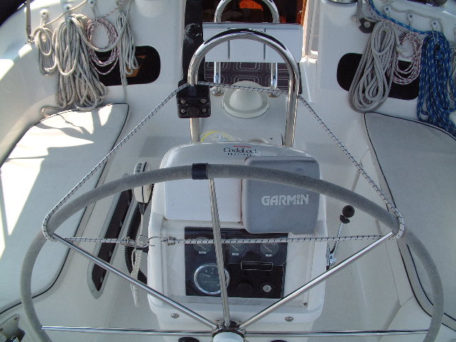

I just center the rudder and snug the wheel down with a bungee. I loop it around the pedestal and hook the spokes. Not so tight that it doesn't move at all. Just tight enough to let it wander a little bit.
When I need to steer (without removing the bungee), I can easily override it as the hooks slide up the spokes to the hub when I turn the wheel hard over. I find that no matter how sloppy the boat wakes might be when we're anchored, the rudder is always centered with just a slight amount of movement to ease the stress. The rudder never slams against the stops like it would if the wheel was untethered.

Feb 10, 2004
4,252
Hunter 40.5 Warwick, RI
