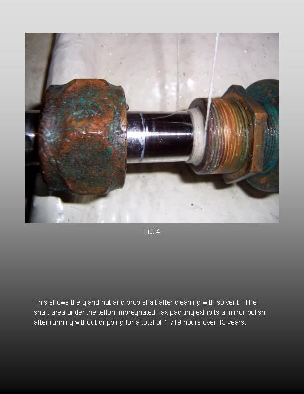

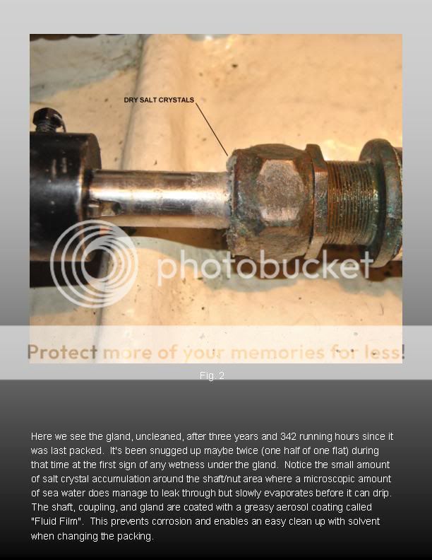

However, for a number of years I have been chiming in here on packing glands leaking and the fact I have run mine bone dry almost from the day I bought the boat new in late 1998 as a '99 model H310. As mentioned in several old threads, back in 1999 I discovered that if the stuffing box were packed with teflon impregnated flax, I could hand tighten the gland to the point where there was no water dripping and yet the gland stayed cool to the touch. Why so when this spells sure disaster for others ?

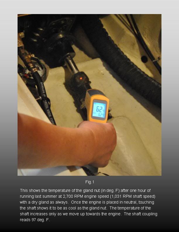

  • I'm told the cross sectional area of the prop shaft can't possibly transfer the frictional heat of the rotating shaft into the cold, cold sea. No, it's really the two or three drops per minute of water leakage that carries the heat of friction away (try calculating just how much heat energy three drops of water contains even allowing for a 100 F. deg. temperature rise).

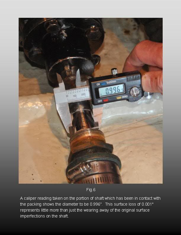

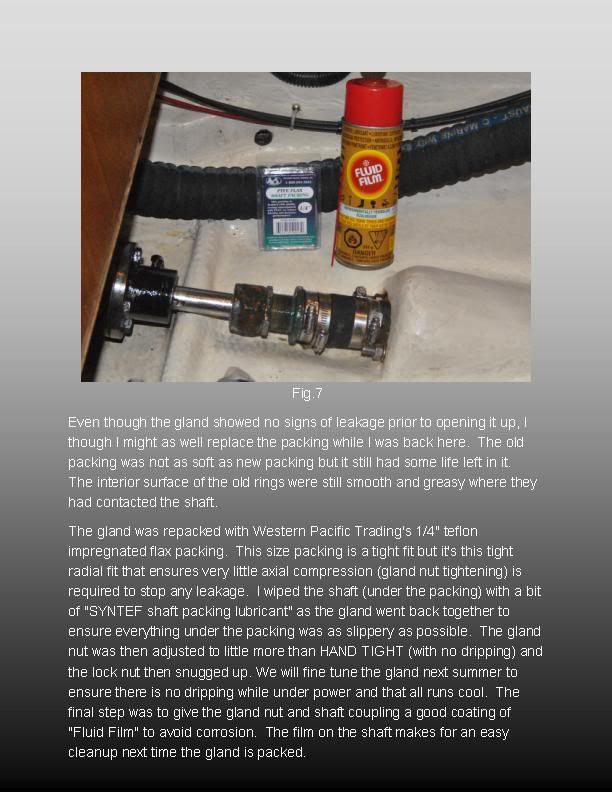

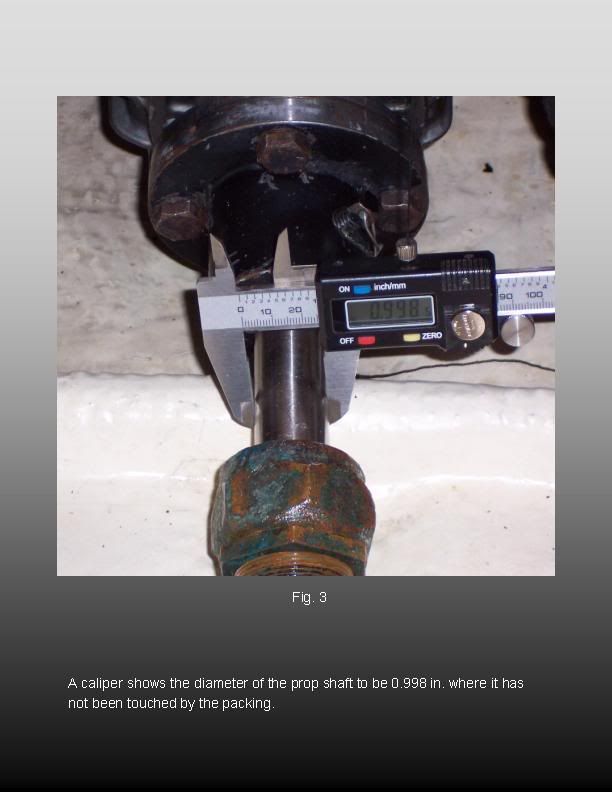

What makes this packing work very nicely without any leakage are such basics as: proper installation, light compression of the packing, ensuring the flax packing is indeed impregnated with teflon, maybe a bit of SYNTEF lubricant during installation .............. oh, and one other thing, the shaft surface speed - the most important detail of all.
Sailboat props turn at reltively slow RPM's with low shaft surface speeds. In the above case, the surface speed of the 1" shaft (while cruising) was 270 ft/min with no damage occurring in over 1700 running hours. I think the photos demonstrate that 270 ft/min is a low enough surface speed to avoid any problems while running with no leakage. However, if the surface speed were continuously increased (as might be found in a high speed power boat with a larger diameter shaft), there would come a point where the heat from the friction would start to cause problems for the packing and ultimately the shaft if run dry. As the above shaft runs at 63 deg. F (17 deg. C) I suspect this overload point would not occur until there was quite a significant increase in the shaft surface speed.

I feel a lot better. Six years ago I replaced the packing on the prop shaft with Teflon impregnated flax. At just over hand tight, the gland either didn't leak or dripped just a little. The gland never got hot, so I just kept an eye on it. As everyone knows, it should have been leaking steadily. Over 1,000 hours later, I repacked the gland and the flax looked like new, as did the shaft. All this time, I was worried that I was doing something wrong. By the way, my friend's dripless shaft seal failed catastrophically and gave him one of those frightening moments we would all rather avoid.
