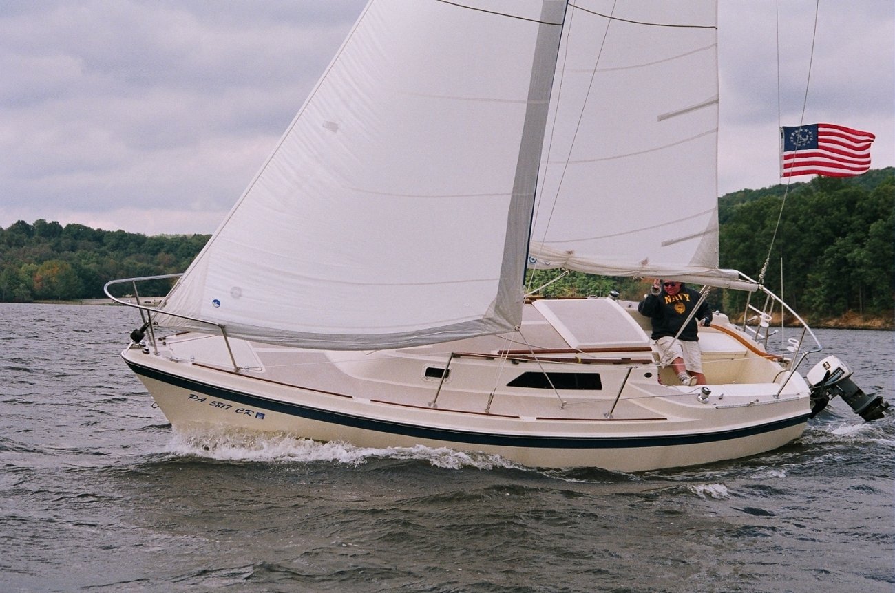

Is your 25 a 1983 or (rare 1984) model?? If so, the window layout was updated for 1983. The "G" in the HIN indicates 25, as mentioned above, the 26 used "M". The 26 was introduced as an 1984 model, typical O'DAY phase-in, they still made a few 25s during the early part of the 1984 Model Year. Here is a picture of a 1983 model 25 (not my boat, but I have a large collection of O'DAY pics)

Yes- I have an 83 25' with the one large and one porthole windows.
