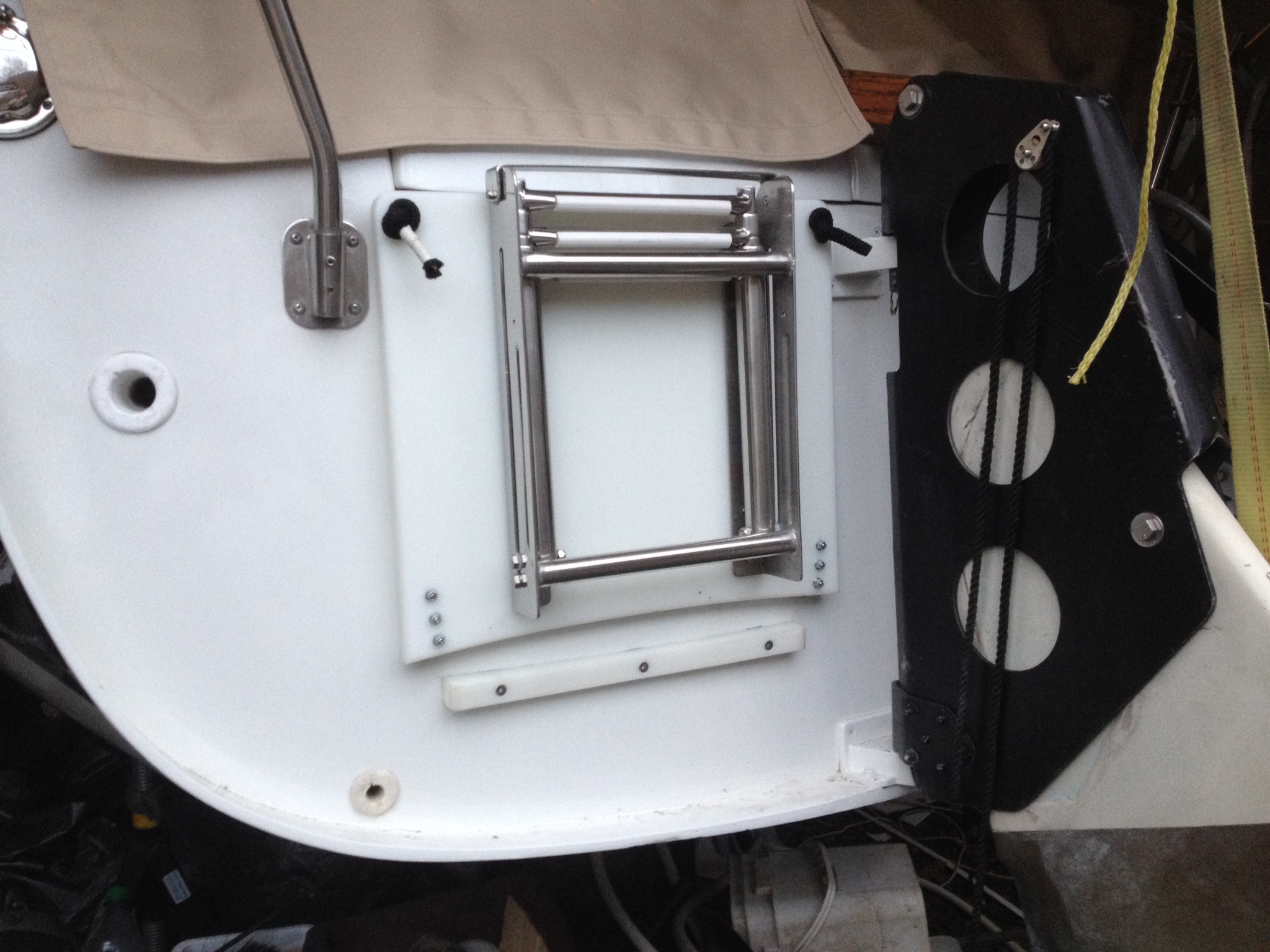

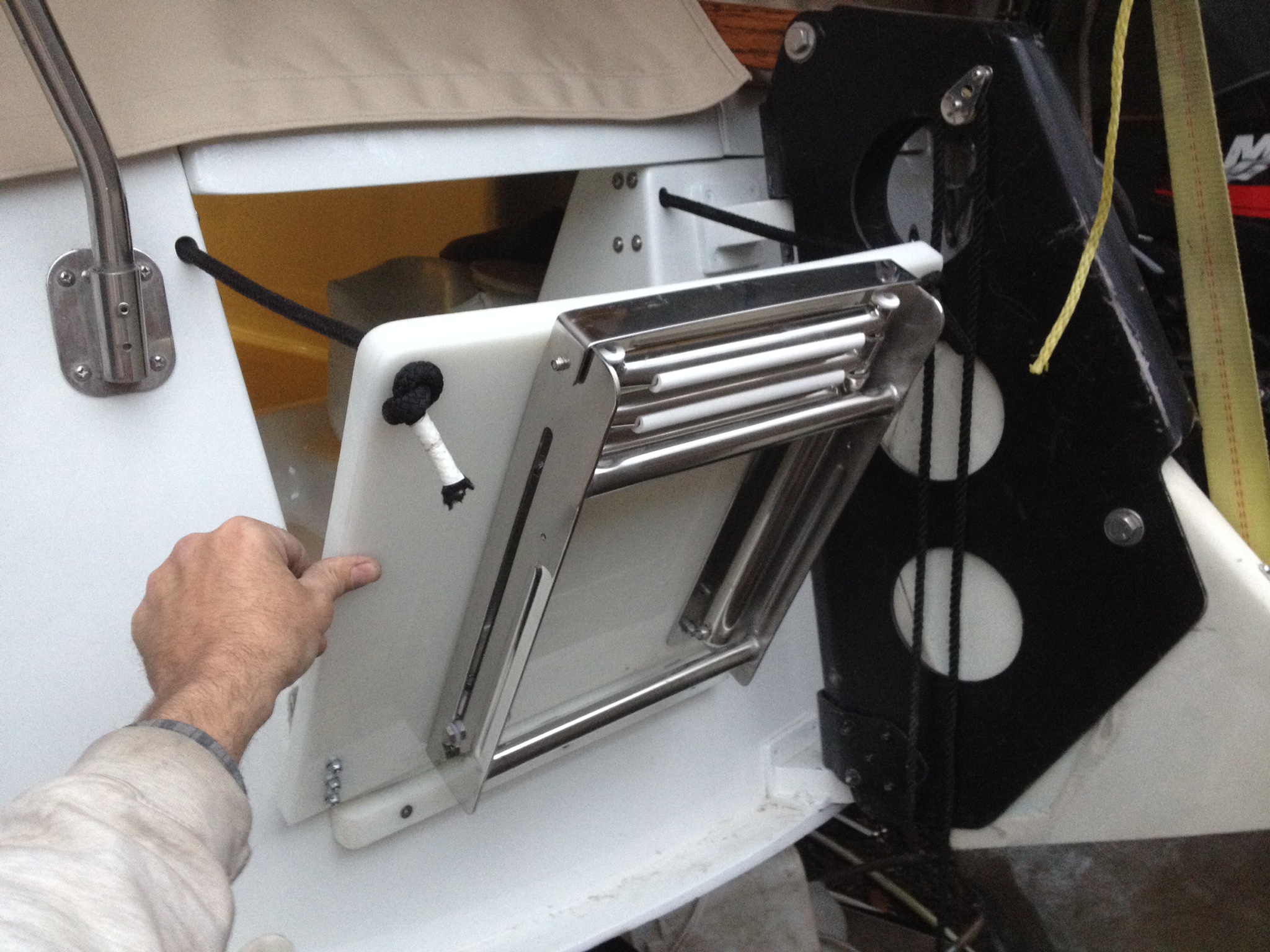

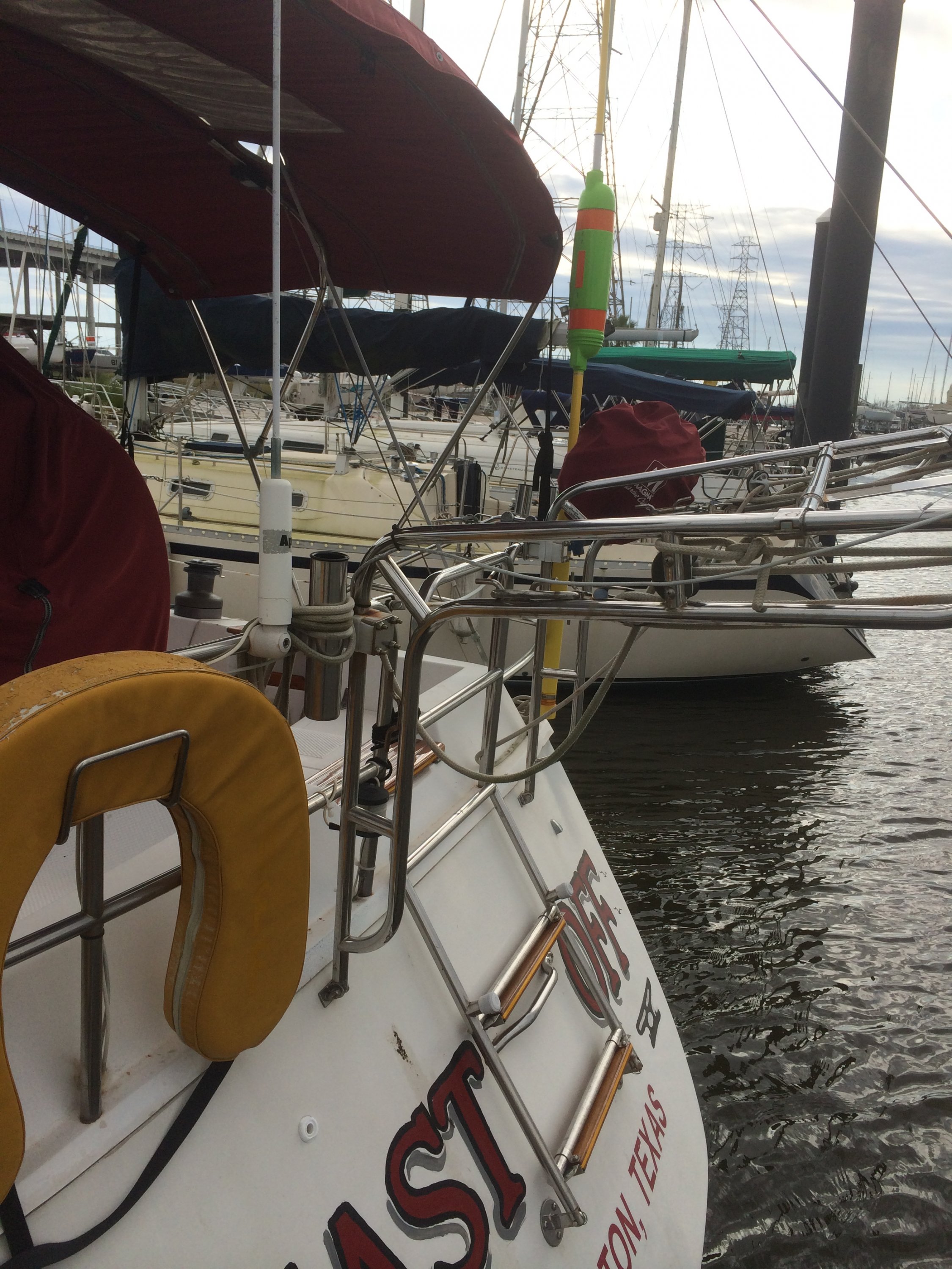

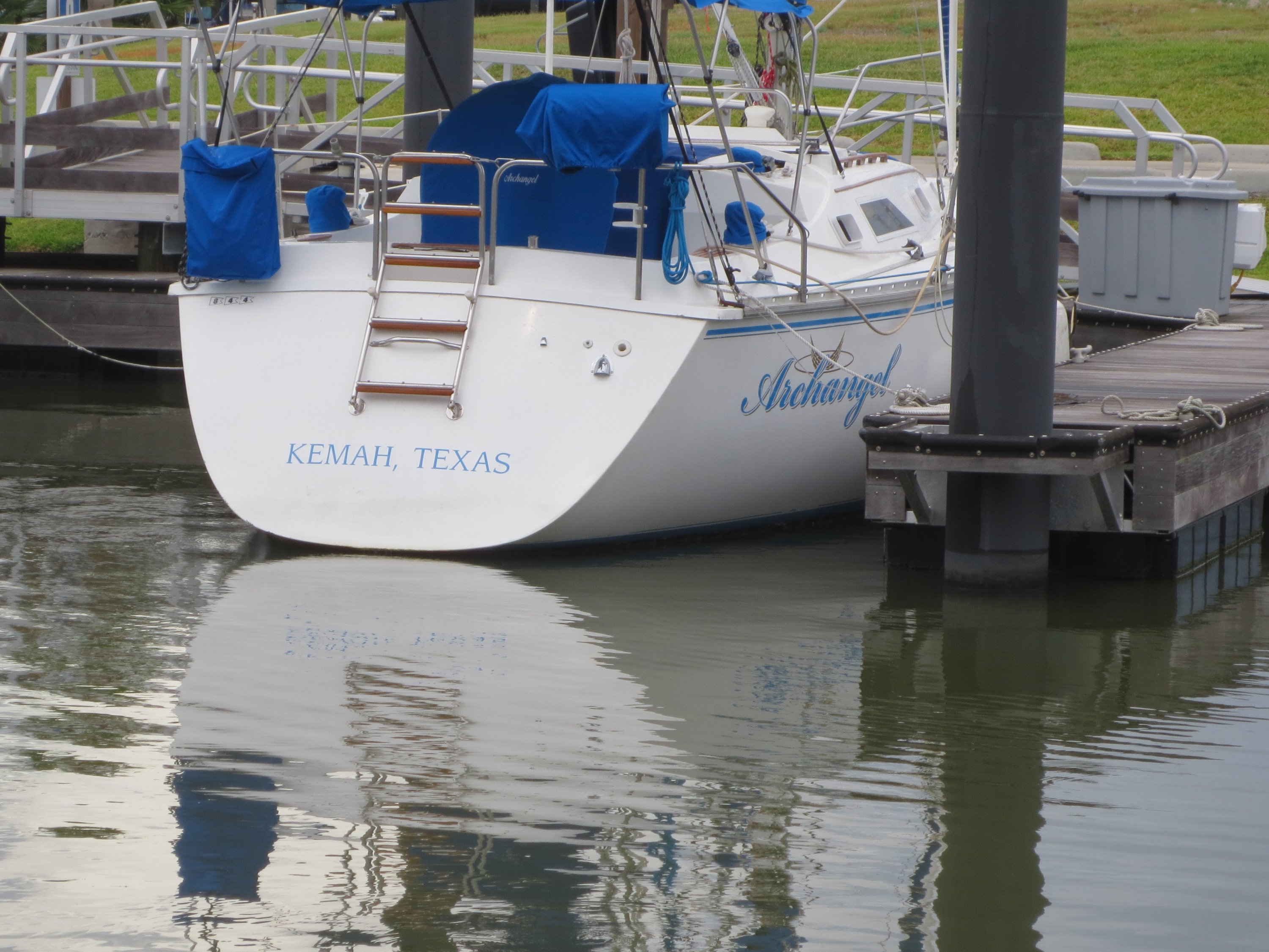

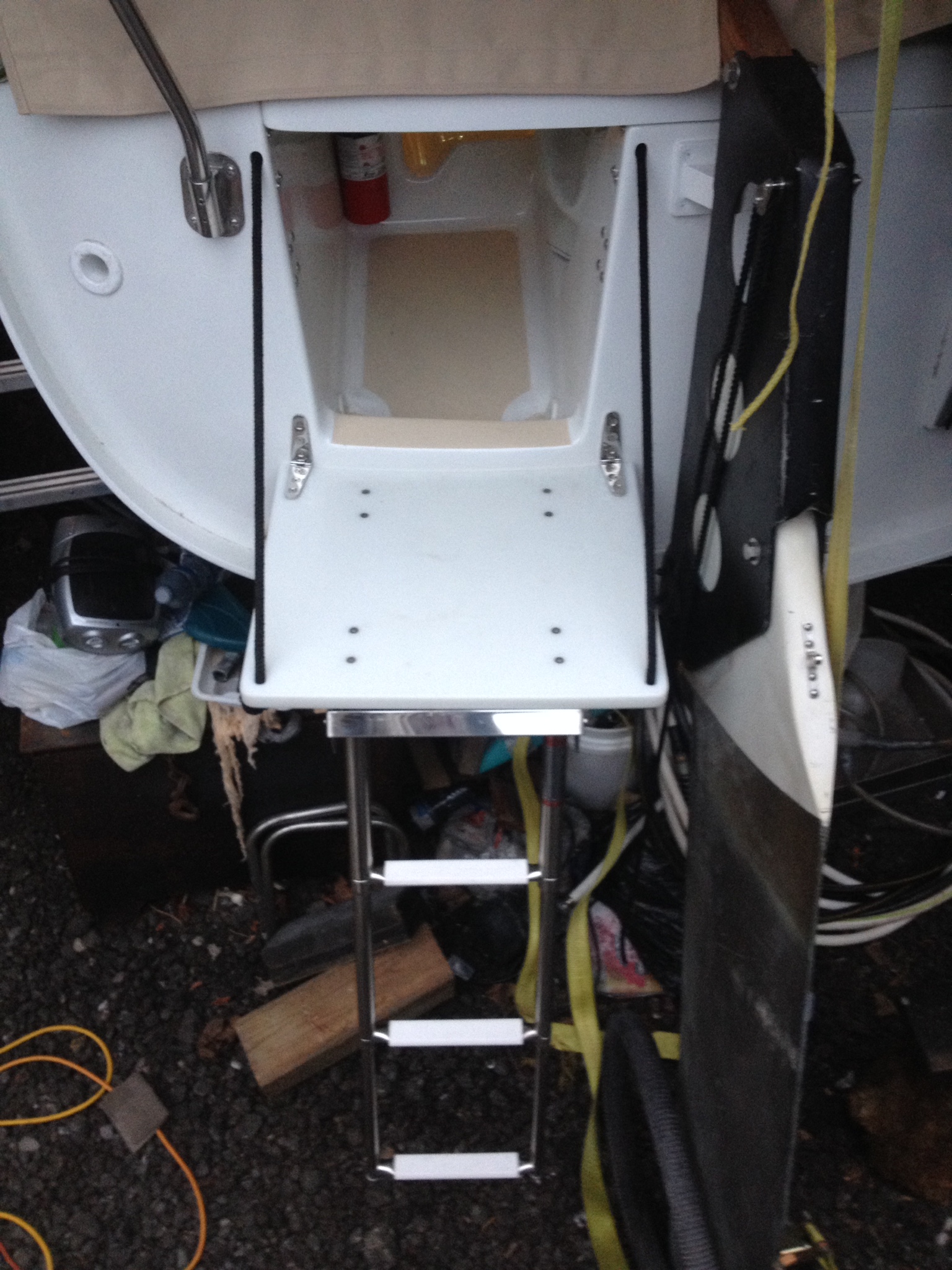

Hunter 31_83-87 New Orleans
Attached are pics from a mid 80's H31 and H34. Basically its the attachment point on the hull for the SS ladder and then upwards for storage you can see the angle. the attachment point is circular SS material bolted into the stern with a stub that the ladder end slides over and is held in place with a clevis pin/circular cotter. think this could be made from other materials to suit your needs. if you need measurements or addl pics off my H31 let me know.
