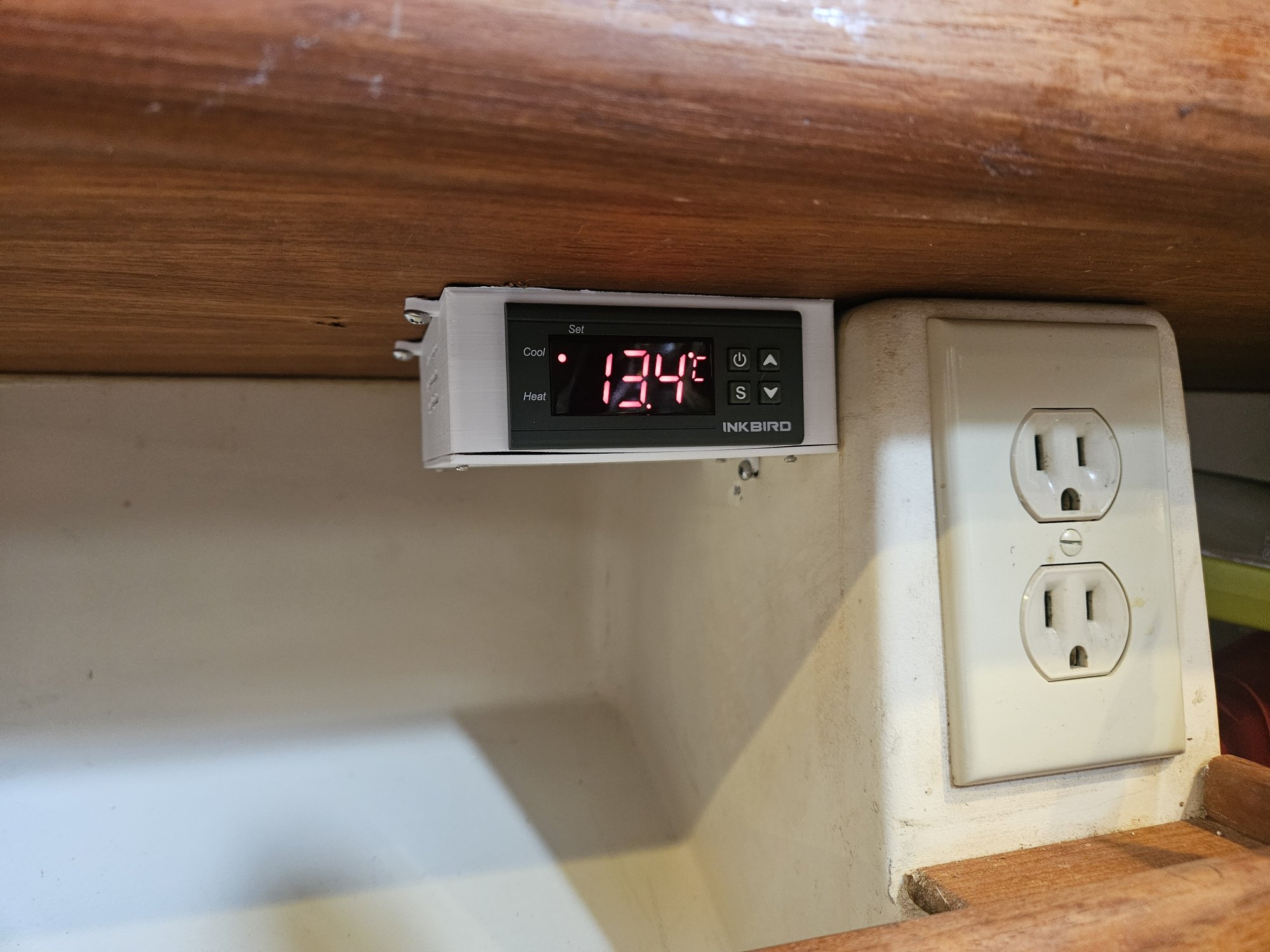

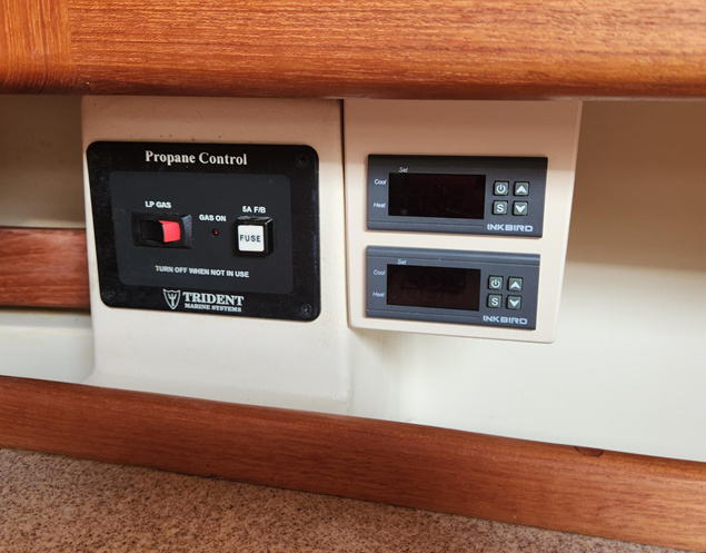

The first iteration used a cheap $20 amazon thermostat (Inkbird) to activate the spillover fan when needed and an internal fridge compartment circulation fan to circulate cold air up when the fridge got too cold (below 1.5 deg C). This got us down to + - 0.5 deg C..... but, sometimes at the cost to the freezer compartment, which could reach -1 to -3 deg C in the top. This would soften the ice (kept near the top) and increased frost on the evaporator plates... thus slowly reducing the accuracy of the freezer thermostat and the efficiency of the system. (yes I know, ice cube trays / bags should be sealed to avoid inserting moisture in the compartment....)

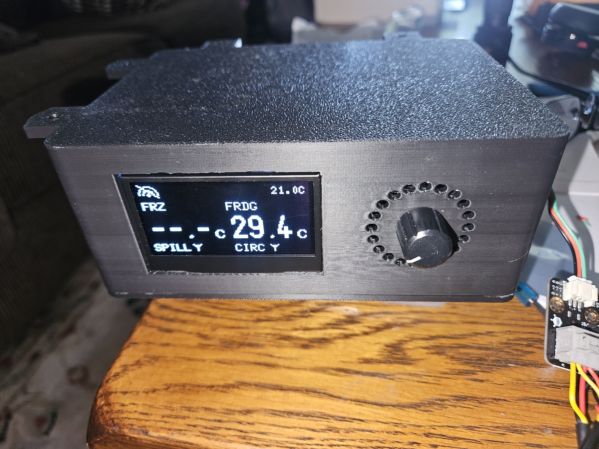

Setup can be done via webui (connect to the esp32 vs it's own wifi access point) or via the rotary encoder ( knob) right of the OLED screen. I was going to use a small touchscreen at first, the changing values would have been tricky as the touch areas would have been small and there'd be no tactile feedback. The screen can be set to sleep after x minutes but will wake if there's a new alarm trigerred.

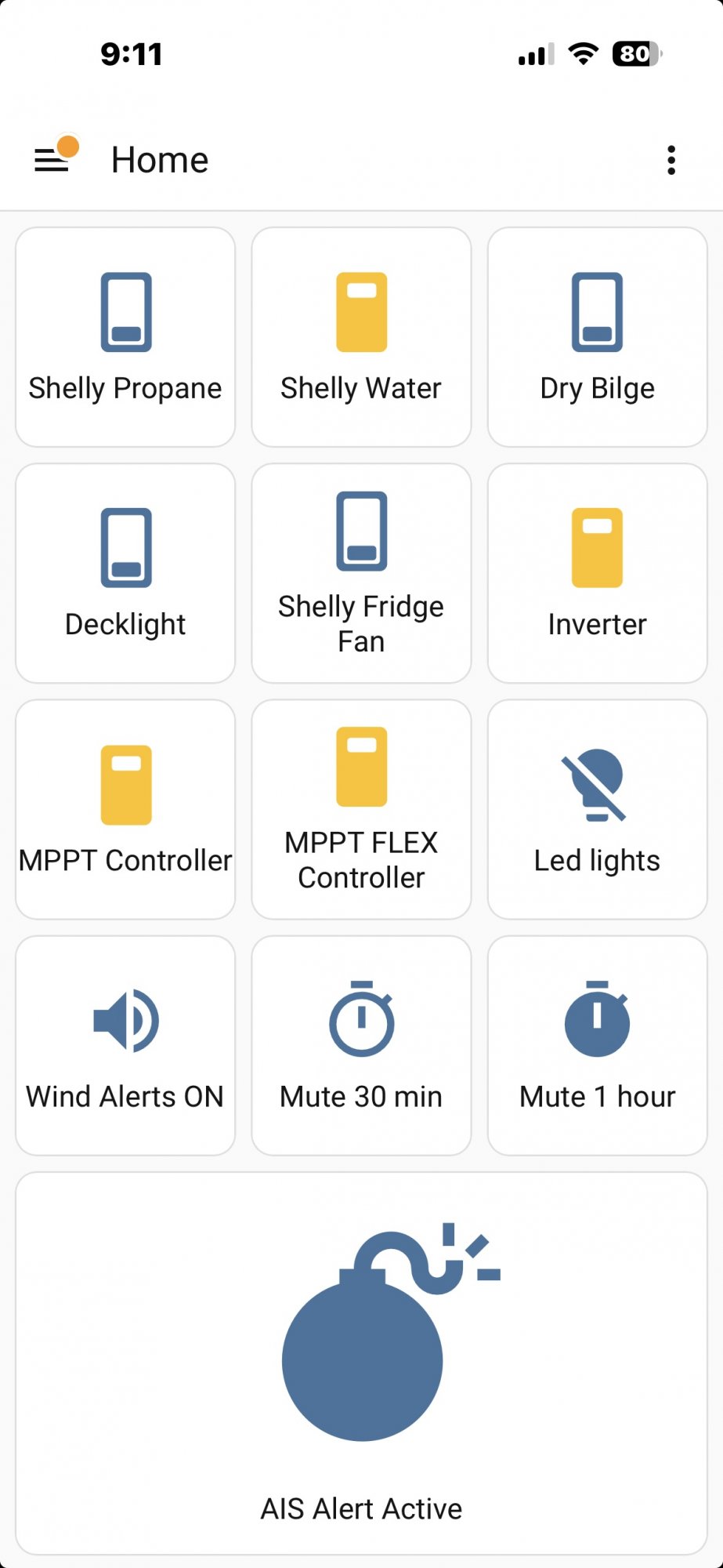

SignalK can run on a CerboGX (install Venus OS Large) but there isn't a lot of overhead on the Cerbo when it's also connected to an NMEA2000 network. If the CerboGX is connected to N2K, a seperate instance of SignalK is preferred. A RaspberriPi 4 or 5 is very power efficient and (like a DC wifi router) can be left running 24/7, especially with a display off or used in headless mode.
The Open Marine Data Platform (can be installed on a PC, Raspberri Pi, CerboGX, etc...)
SensESP Home (this is the main code that runs on the ESP32 microcontroller that handles UI, wifi comms and messaging to /from SignalK).
After the device is installed on the boat and tested for a week, the next logical step is to try to skip SignalK as an intermediary. If we can send the temps to Node-Red, Node-Red can run on the CerboGX (it's much lighter on the CPU) and send the data natively to the CerboGX.
