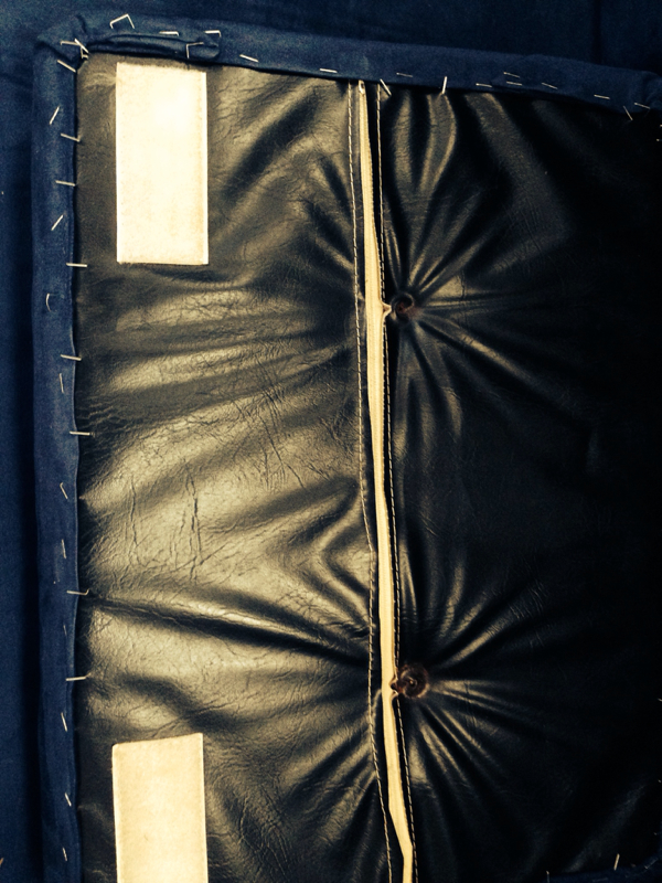

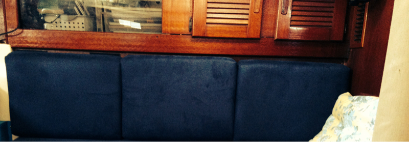

Has anyone reupholstered a backrest without taking it off? Would like to wrap it and use Velcro, but not sure how to attach the other half of the Velcro to the plywood/old fabric side.
I stapled the new fabric to the back of the backrest
