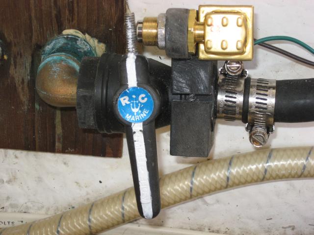

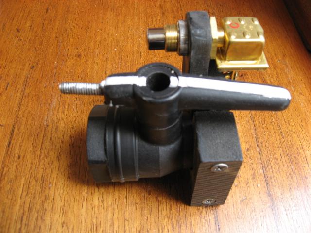

The cure for me was to mount a momentary-on push button switch on the raw water seacock in a manner that the button would become depressed (= on) when the seacock handle is in the shut position. The alarm buzzer in my 1980 Yanmar instrument panel has an unused terminal. Wiring this to the seacock switch created a circuit for a "Seacock Not Open" alarm. When starting the engine, if the alarm buzzer doesn't go off in its usual two/three seconds, the first thing to do shut is off the engine and recollect that I didn’t open the engine seacock.

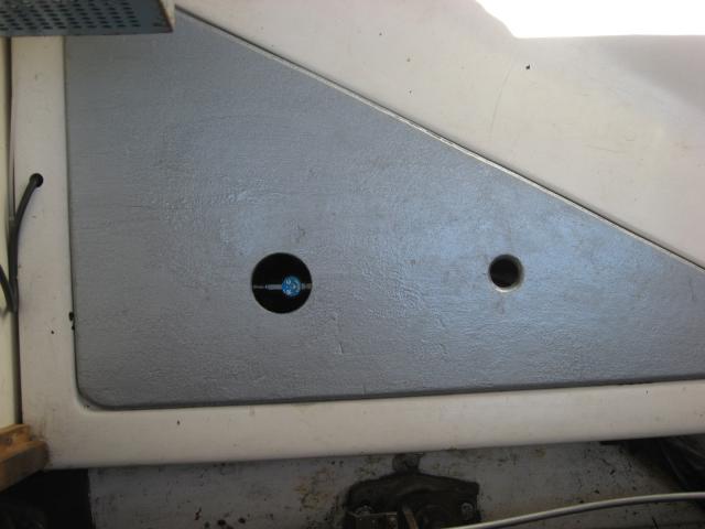

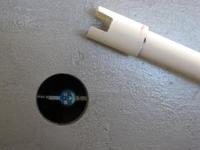

The attached pictures are of the switch setup at the seacock. The marlon valve handle is hollow so I was able to epoxy an SS extension bolt into it very securely. I filed smooth the threads on the side that contacts the switch’s chrome button. Also is a picture of how the valve handle looks when the cover over the area is in place and part of the pvc pipe that I use to reach down to the valve from above. The other side of the pipe has a T-fitting.
This alarm circuit might not be the most elegant solution, but its working. It won’t tell me if the raw water flow is blocked for some reason, but I figure blockage will be a fairly rare occurrence compared to me forgetting to open the seacock. The push button switch I used has a rather stiff spring so it’s a good thing that the seacock ball in the valve fits tight and offers resistance through the handle. If I were to do it again I would find a switch with a softer return spring.
