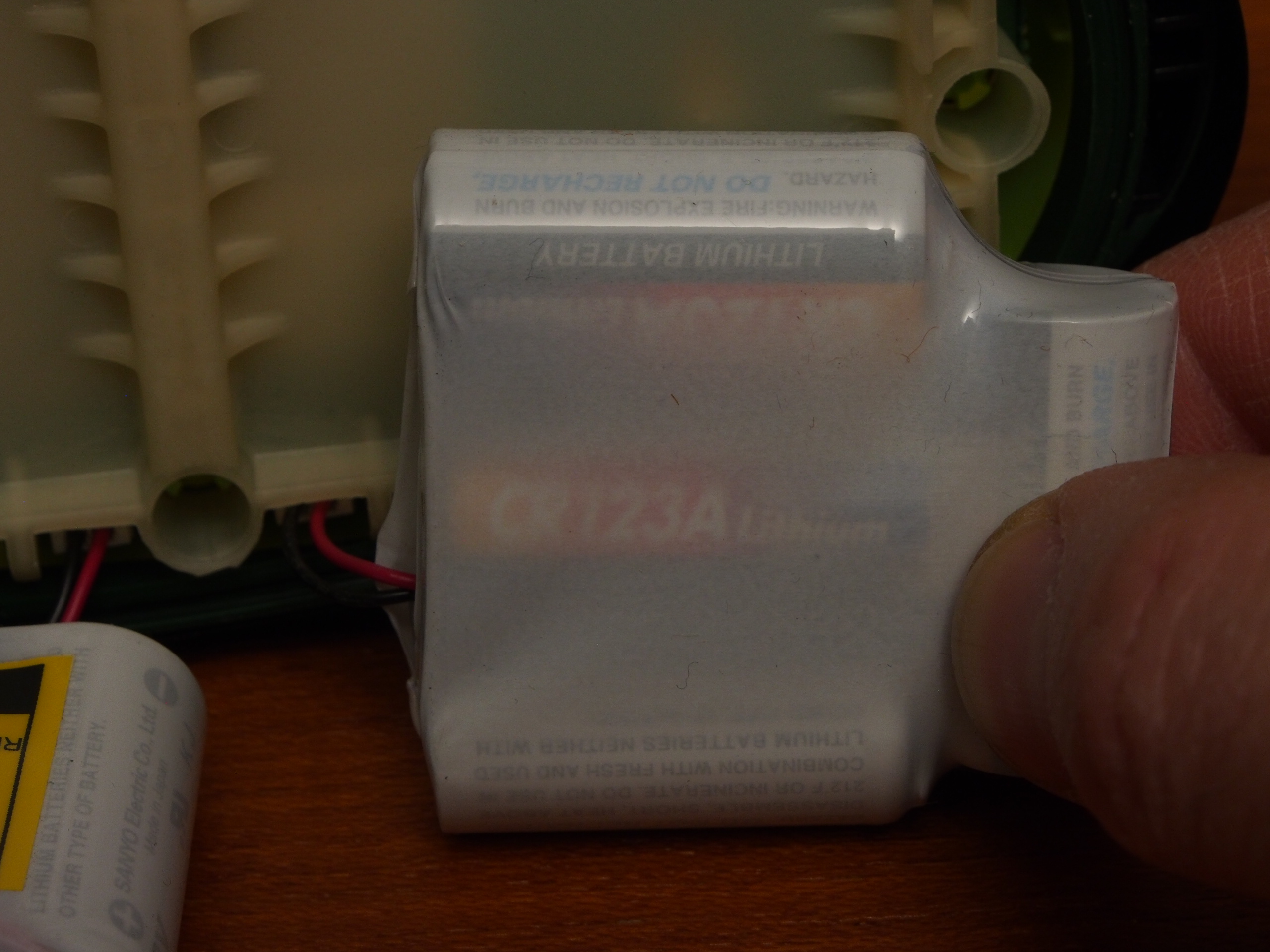

I'll add another data point to the discussion. I have a pair of ACS PLB-200s that are new in the box, but the battery expiration is 2013. The cheapest priced I found to have the batteries replaced is $125 per unit at several sources. Since I had nothing to lose, I opened the case of one of them to see what the batteries were. There are two, four-cell packs made up of GE/Sanyo CR123A batteries. (see photos)
I don't have the equipment for spot welding leads to CR123A cell, so I checked online for CR123A-T cells with tabs. I found GE/Sanyo cells for $3.25 each, for a total cost of $52.00 for the 16 I need, plus shipping: http://www.energexbatteries.com/products.php?product=CR123A%2dT. The tabs are long enough that I should be able to solder them directly together (with lots of surface area at the joints) and easily prevent any significant heat from reaching the cells. BTW, BatteryMart was over twice as expensive, at $6.75 each for the exact same cells.
Examining this unit, there is only one seal on the case and it's a pretty robust H-track. I don't see how it could be reassembled improperly and unless someone ham-fisted the screws and cracked the case, it's not going to leak after reassembly. So the bottom line is that I can spend $250 to have the batteries changed by someone (probably taking all of five minutes) or less than $65 for parts (with shipping) and a few minutes of labor to build new battery packs. The choice seems pretty straightforward to me.

Awesome. Nice shrink wrap for that professional touch. :biggrin:
Those are the original factory battery packs, so I can't take credit for the construction. However, I fully intend to build new packs that look - and function - just as good. Fortunately, I do know how to solder, so this will be a piece of cake.
