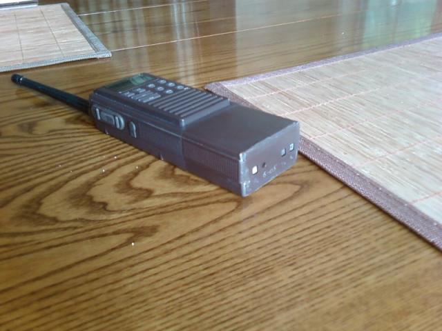

So I have this perfectly good ICOM IC-M1 handheld radio. It is about ten years old and I replaced the battery pack about five years ago. The current battery won't hold a charge for more than 30 minutes. I contacted ICOM and they don't make the battery any more.
Any suggestions?

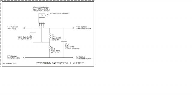

My Solution to Same Problem
Yup.
My battery failed too because, fed up with the radio never being charged up when I needed it, I had mounted the charging shoe on my steering console and connected the 12V so it was always on charge when we were aboard. I knew this would eventually kill the battery but was shocked when I found out the price of a new one.
So, undefeated, I took a craft knife to my battery intending to replace the NiCads with standard AAs. Unfortunately they were 3/4 length AAs and I couldn't get any of these as they were special manufacture.
Then I built the circuit below into the existing box and superglued it back together. I already had a curly cord in my scrap bin, put a cigar lighter plug on it and this completed the job.
Now it NEVER runs out of battery.
It's not too clever for calling the coasties from a liferaft though!
Sorry about the dreadful quality but uploading shrinks my 132kB .jpg to 11.8kB.
If anyone needs a more legible copy then PM me via this site.
