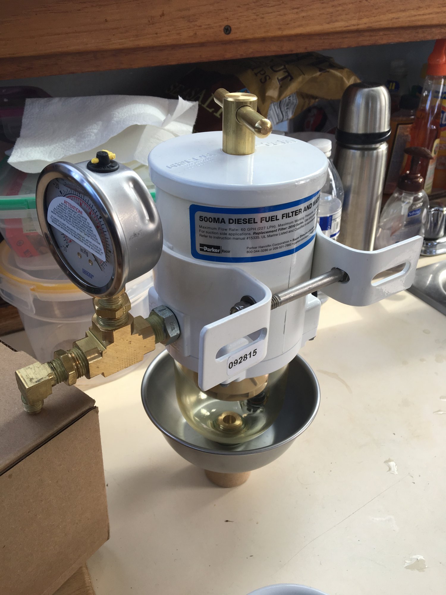

FWIW... I have a Racor 500M primary filter. I added it to the boat.
It takes less than 10 minutes to change a filter.

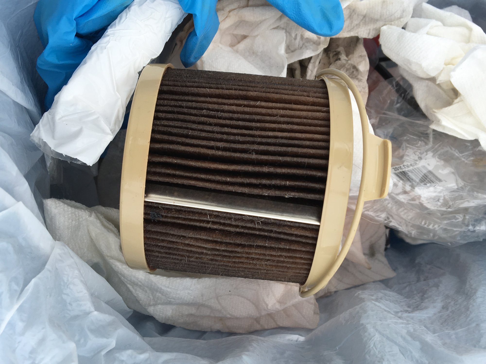

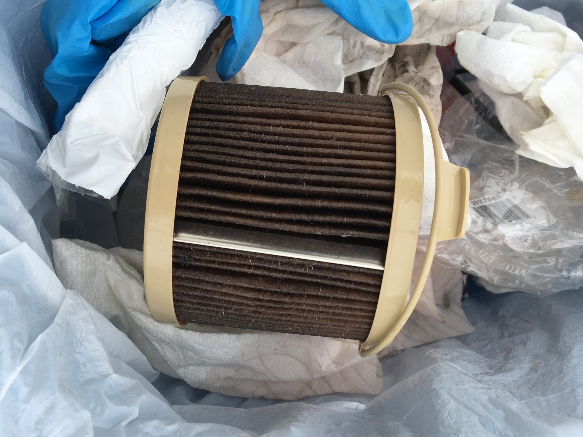

Here is what a clogged filter from dirty fuel looks like...
Filters run about $10.
This one caused the engine to be starved of fuel. The engine shut down. I do not let it get this bad anymore. Using Biobor JF each time I fuel has cleaned the fuel in the tank and I no longer have a clogged filter. I change it maybe once a year now. No more fuel issues.
