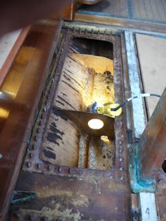

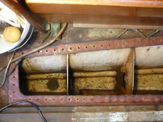

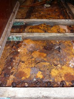

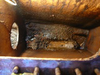

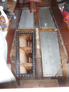

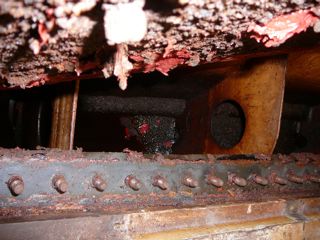

I've been cleaning out the tanks and making new covers, so I thought I would chime in even before I'm finished. The four covers were 3/8" steel plates with paint. Weight was ~60 lbs each. They were severely rusted on top - with thick flakes coming off, and a lot of dark sludge was in the filter. Attempts over the last few years to pump out the bottom of the fuel through the tank level sender hole brought up rusty steel bits. I soaked the nuts with penetrating oil (Kroil) for a month before removing the nuts. Only a few bolts broke, and one bolt rotated in the fiberglass and the nut was ground off. I have replaced all the bolts with stainless. The bolts were threaded through the fiberglass deck that holds the covers, and removing them (downward) took some work. The bolts are tightly threaded into the fiberglass. The outboard bolts did not have enough room below to allow their removal. They were apparently inserted into the fiberglass before the fiberglass deck piece was glassed into the hull. There was room to back off the bolts enough to saw off the heads, and to then remove the bolts from the top. I am replacing them with bolts from the top, with nuts beneath, after which I cut off the heads to leave studs sticking up like the rest of the bolts. I spent a fair amount of time sorting out how to get all this done once I was committed to replacing all the bolts.
The bottoms of the steel covers were raining down rust and paint strips into the fuel tank. At the deep aft end there was about an inch or so of rusty sediment saturated with black slime. Overall I removed a gallon or so of this from the tanks. I scrubbed out the tanks, and steamed them with a small steam cleaner (barely adequate). There was staining from Permatex that was used to seal the rubber gaskets beneath the covers, but overall its much cleaner now. I discovered one broken nut on a keel bolt (which are all exposed now). All the bronze nuts and bolts have a hard dark surface now that may be from the steel and rust in the fuel. I will replace all the nuts.

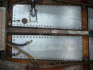

The new covers are 3/8 aluminum, chosen over stainless because its easier to handle, cut and drill. The supplier sheared the pieces to size. Nils Heldenberg(?) suggested using painted steel again, since it had lasted for 40 some years, but I thought Al would be an improvement. I have all aluminum fittings, and the only contact will be with stainless washers on each bolt.

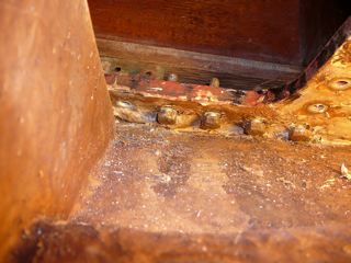

Here are more pictures of the tank construction. The bolts shown that had to have their heads sawed off are in the corner of the forward tank. There is a conduit in the outboard corner of the tank that can be seen that drains the forward bilge into the aft bilge.

Wow! Thanks for these photos Rick.
And thanks to Bill as well, I've often wondered what's going on down there.
Quite a project Rick. I'm curious why you decided to redo the existing tanks as opposed to installing smaller tanks in the space? I suppose the reason many tanks were uncovered and new tanks built or fitted was due to leakage at the keel bolts that some owners have dealt with. But with no leaking problems, the tank as designed seems to work well, why not keep it?
There's very little rust on the tank tops on my boat which makes me wonder if they've been removed in the past and repainted? The rust your photos show is alarming, especially to think it was as bad below. I wonder about the lower face of my tops seeing those photos.
One other question to both Bill and Rick, I assume you saw no problems to the interior hull fiberglass when you were inside the tanks? Thanks again for the info, the photos are especially helpful.

Rick, quite a job you've done! What did you use for gasketing? Did you go to any effort to isolate the bolts and washers from the aluminum?

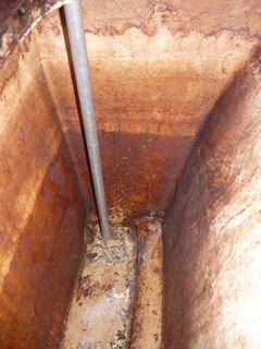

Well, the tanks are done and the boat sailing - got from Mattapoisett tp Quisset last Friday.
Answers to questions: There was no indication of degraded fiberglass in the tanks, although I'm not sure what it would look like. I briefly considered putting on a barrier coat, but after I saw the interior of the tanks and considered that there was at least some penetration I didn't think it was a good idea, since it probably wouldn't adhere. I didn't want to think about grinding the inside of the tank! The picture shows the staining of the fiberglass from the fuel, and a bit of the somewhat rough surface on the bottom. I didn't replace the tanks since that was a bigger job and would make the keel bolts hard to access. One keel bolt nut had broken, all had a hard black/brown finish and all nuts were unmovable. I doubled the nuts on the bolts that showed enough thread and replaced the broken nut. Rumerys put new tanks in Black Pearl, but she had a leaking centerboard trunk and there was little choice. I sealed all the bolts and nuts underside with 5200 (which may have been used before). I made new gaskets from 1/16" buna rubber from McMaster Carr, and used Permatex.
Comments: A lot more work than I expected, but we still have a couple of months of sailing! I put in a second pickup tube that bottoms in the lowest point in the tank, which is aft - see picture. This will be for pumping out the bottom of the tank, and is also a perfect dipstick tube for checking fuel level (I installed a VDO tube level sender as well). The main pickup is further forward starboard and off the bottom by an inch or so. The filler fitting is attached to a separate plate that lowers the profile and also provides an access port if needed (at least to one chamber). If the weld fails the smaller plate is all that needs to be replaced. Fittings will all be aluminum (Some are brass/bronze now but I will replace them next winter).
I have an electric fuel pump between two Racor 500 filters. I disconnect the pump output from the second filter input and pump from the tank to prime the pickup tube and first filter. This also let me pump out the tanks and store the fuel in jerry cans while I did the work. Works great - didn't have to bleed the engine after all the work.
