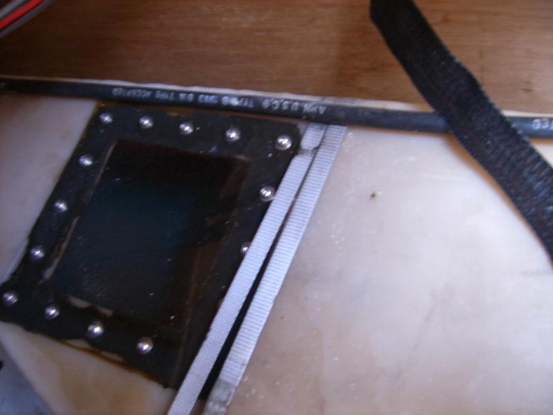

I have a 34 the same age so I am guessing the tank is in the same place- starboard side locker under the seat in the cockpit. I hope you are thin and flexible- it is a tight fit to get down to it. Open the locker and you can see the tank. I did cut a hole in mine and clean it- I took out about a gallon of stuff that you would swear came out of your eavestrough except for the odour. I coveredthe hole with 3/16 Lexan and sealed with Permatex.

Richard, when you cut the holes for the screws, how did you avoid droppings into the tank? Are they just sheetmetal screws?

I drilled the holes with a finer bit- I cant remember the size, then turned the screws in, removed them and cleaned the inside out carefully and made sure no bits were clinging to the underside of the holes. The holes in the Lexan ( actually it was just a polycarbonate not a Dupont product-) are larger and the screws are just self tapping sheet metal ss screws and washers. Think my total cost was <10$. It has worked fine for 5 years
