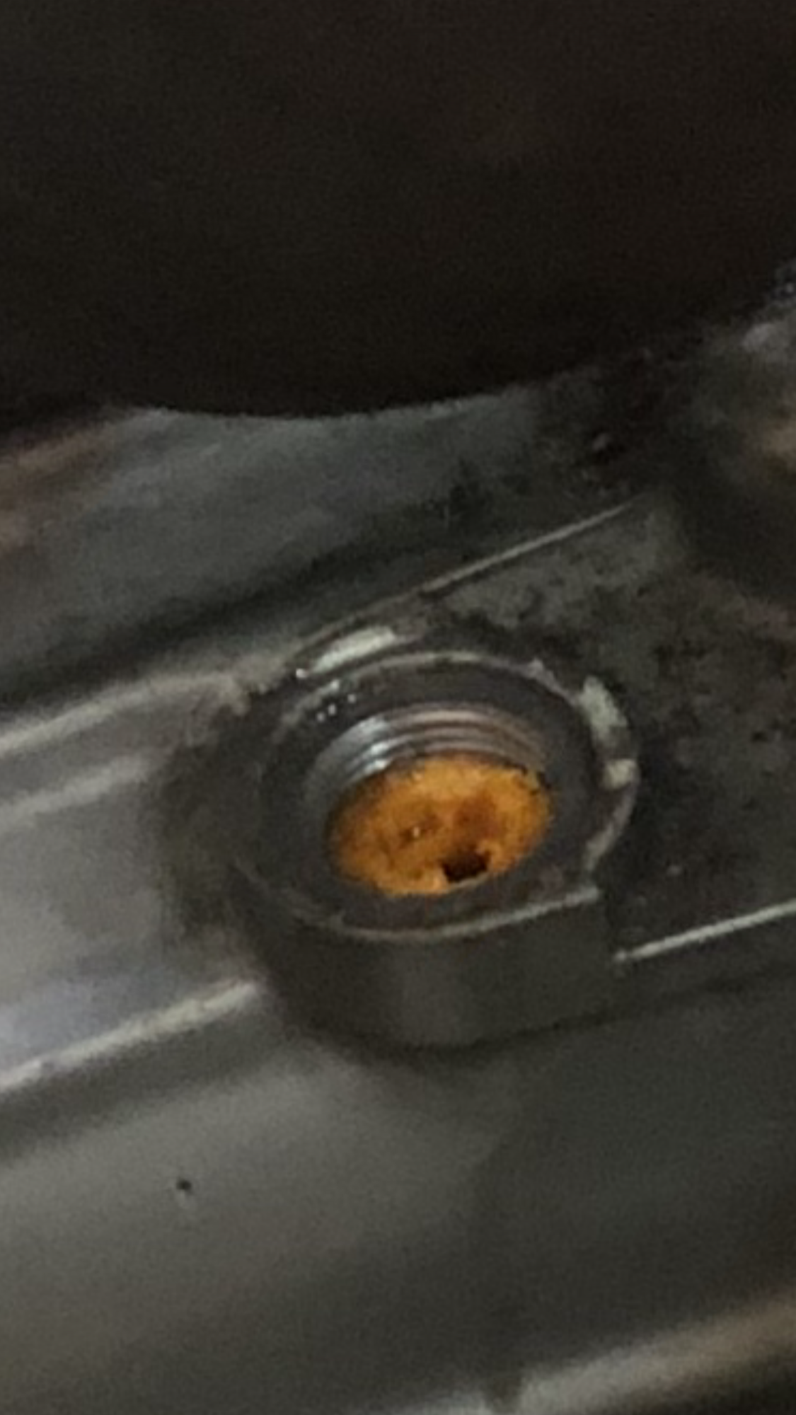

Can anyone tell me how to remove this plastic thread that’s broken off from underneath the top of the dipstick? There’s an exhaust hose 3” above restricting access.

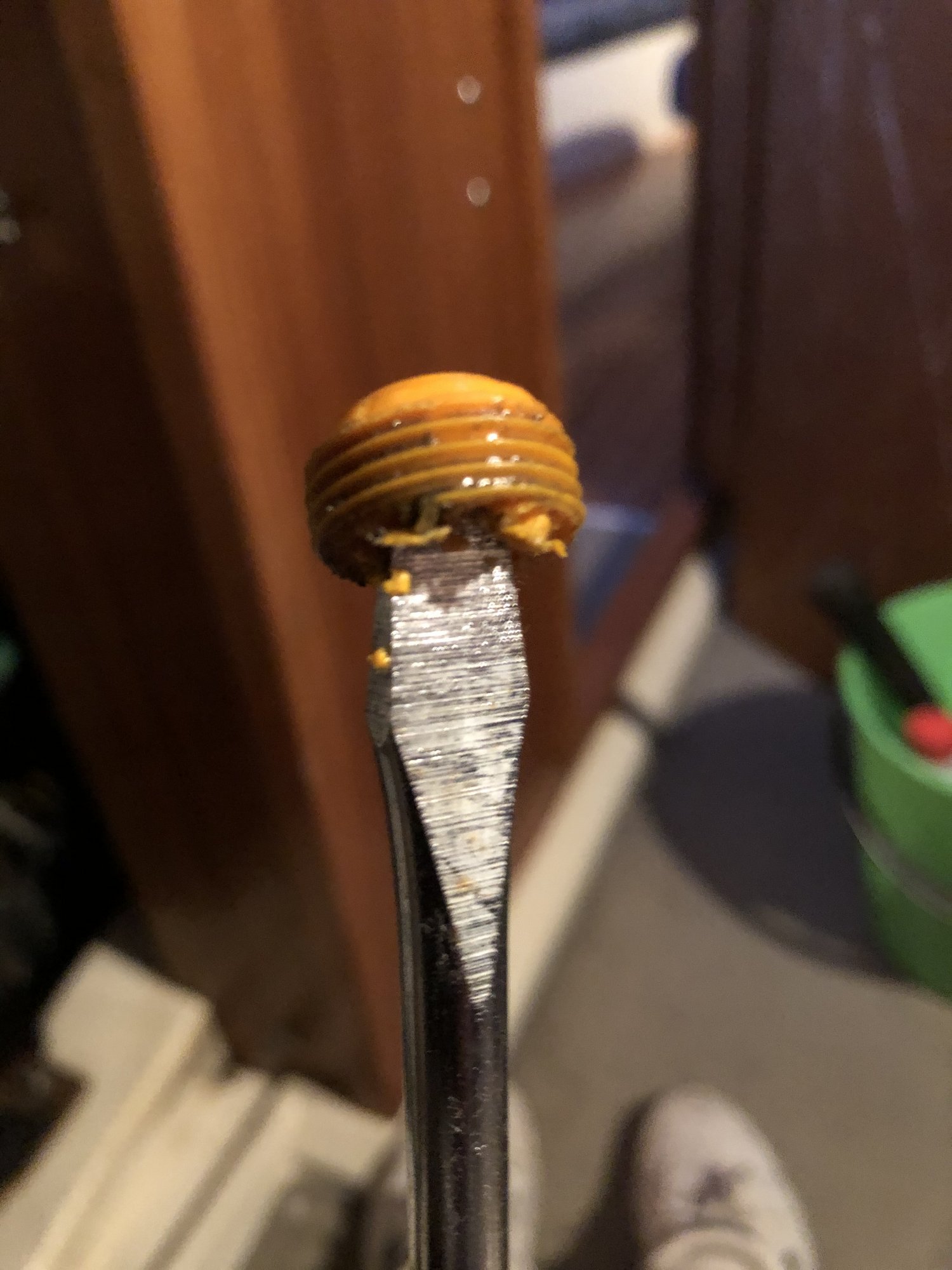

Thanks. I couldn’t get an ezi out in because of the exhaust hose above, but succeeded with a large screwdriver.

I used a knife, which also provided leverage since it was a folder, and the blade sliced into the plastic to provide bite.
