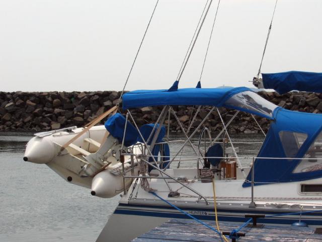

I admit to towing the dinghy (never with the outboard on) when cruising calm inland waters. But I needed a way to store it to go through the locks of the St-Lawrence Seaway and when sailing offshore and I did not want davits nor did I want to store it on deck.
My solution was to install a second halyard (like a main spare halyard) and hoist it to the railing on the stern. It does cover the stern light but when sailing at night with the dinghy hoisted up, I put a light on it that acts as a stern light.
If anchored or at the dock and needing to access the stern ladder, I simply detach it from the railing and bring it to whatever side is convenient, still hoisted but out of the way.

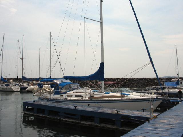

Should have mentioned that the masthead of my boat has 2 sheaves at the front for jib and spare (my spinnaker is hoisted from a sheave installed on a bail above the headstay), and 2 at the back of the mast. One of these is for the main halyard and I installed a second halyard inside the mast (now have a total of 4) for the dinghy.
I obviously also have 4 sheaves at the base of the mast. On the picture, the halyard with green specks going up alongside the mast is the one for the dinghy.
I still have not run that 2nd halyard to the cockpit so in the mean time I hoist the dinghy with the main halyard and when in position, secured to the railing, I simply attach the 2nd halyard to the webbed slings on the dinghy, secure it to a cleat 2 feet above mast base and remove the main halyard.
