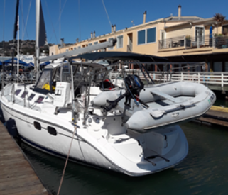

However, there a lots of after-market dinghy davit suppliers to choose from: Garhauer, Kato, Forespar Nova, Edson Marine, Martek, Ocean Marine, St. Croix, Atlantic Towers, etc. They all fit with differing supports and the manufacturers offer excellent customer support to ensure their davits are installed and supported correctly on your sailboat. Some may have photos of your 386 with their dinghy davits. Product differentiators are price and features including carrying capacity in lbs, tubing 304 vs. 316 (better) stainless steel, 1 vs 1-1/4" (better) diameter and wall thickness (thicker is better), one or two cross bracing depending on carry capacity, rail attachments and/or struts, block and tackle purchase, swivels for storage when not in use, tie-off cleats, etc. Suggest making a table to compare price and features of each before you buy. You can also do a search on this forum on "dinghy davits" to see what others have installed and why. I installed Garhaurer dinghy davits (1.25" diameter with one cross brace) myself on my 2004 Hunter 386 below.
Please let the forum know which one you selected and why.
