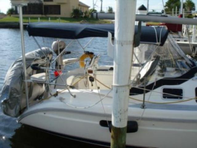

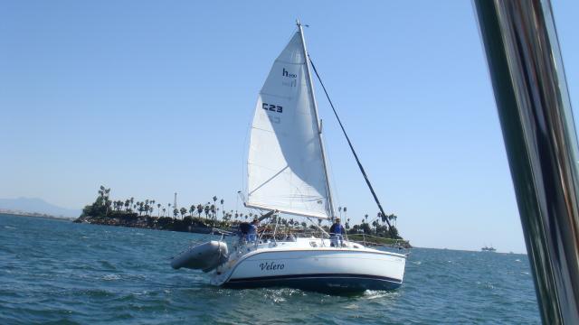

I added Garhaurer Marine Dinghy Davits ($950 and they sell direct) to my H290 and are mounted to stern seats and supported from transom above the swim step. (photo attached) Without the dinghy stowed they are transparent (like the arch) and they make lowering the outboard motor to the inflatable a simple, 1-person task
