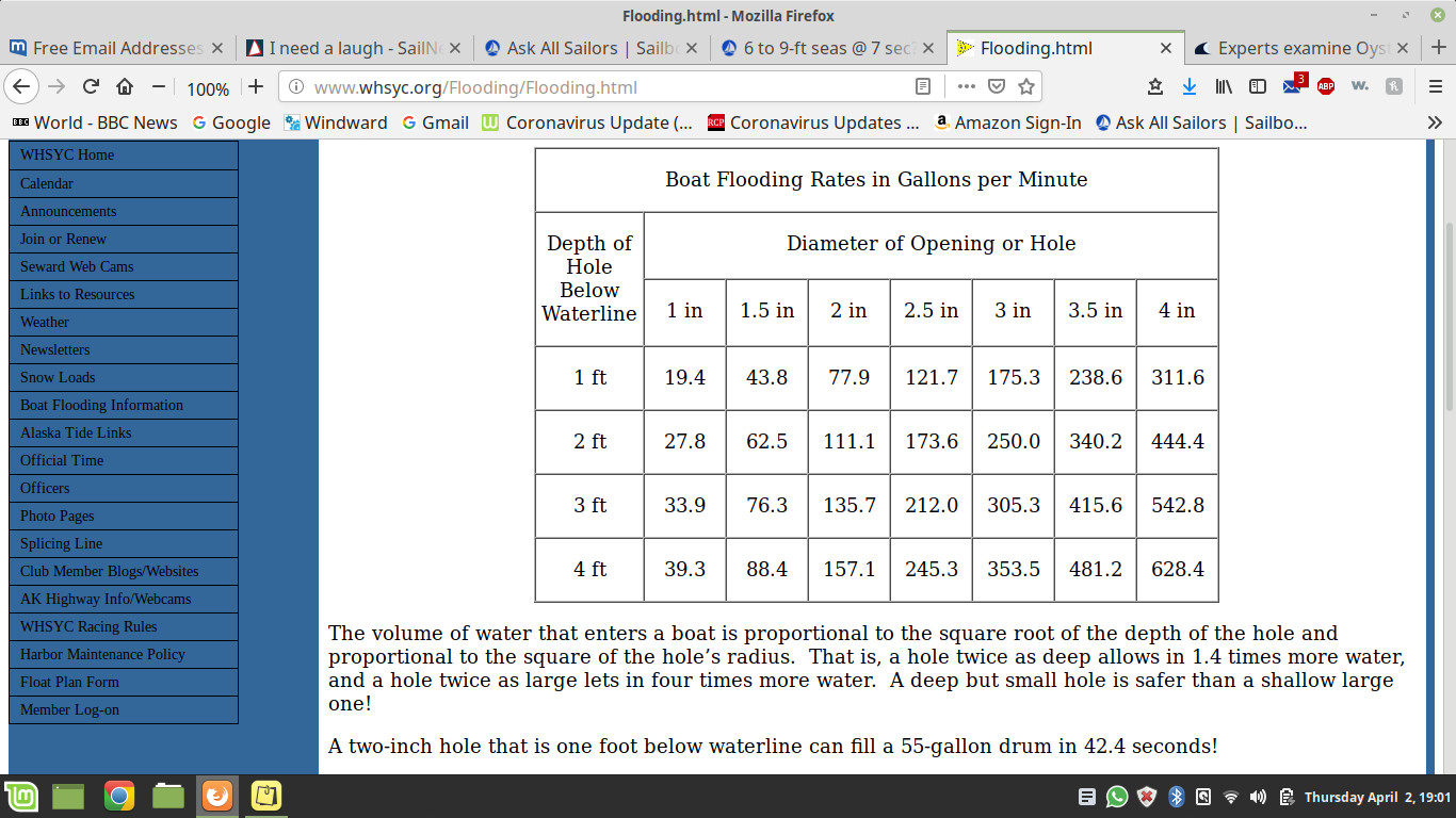

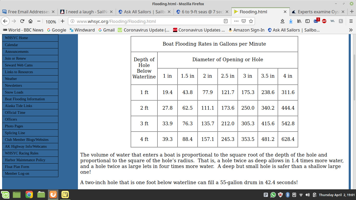

As for pump size this chart might help.

Thanks! Those numbers are quite scary. I'm trying to build an assortment of patch repair items - any advice?
