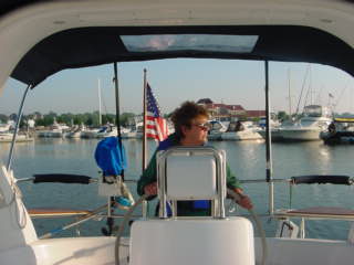

We have a 1999 H380 and put a West plastic motor mount next to the stern seat and it works well. See picture. Really easy to put motor on and off and get to and from dinghy. Did not have to do any mods at all.

John, What size motor do you have? We have a 9.9 hp Mercury and I'm concerned that the West Marine Motor Mount won't handle that large an engine. Thanks, Sue, for asking the question as it is one I've been struggling with as well. Fair winds, Steve S/V Options H380

Yes, we only have a 3.3 Merc that is not even 30#. And the West Marine motor mount is pretty cheezy and I wouldn't use it with a heavier motor than what we have. So if you had a heavier motor, a better wood mount would make sense. As far as a heavier outboard, I have seen bigger mounted with better mounts. Also, we have had some pretty hefty people in our stern seats and it was not a problem. ALthough I held my breath at the time. Keep checking the bolts. It is so darn convienient to put the motor there is would be a shame not to be able to. Good luck with your choice.
