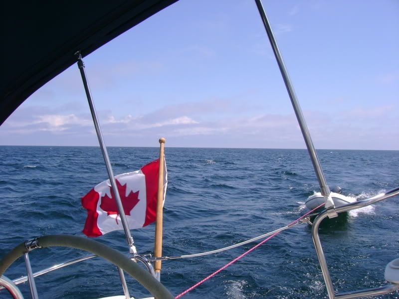

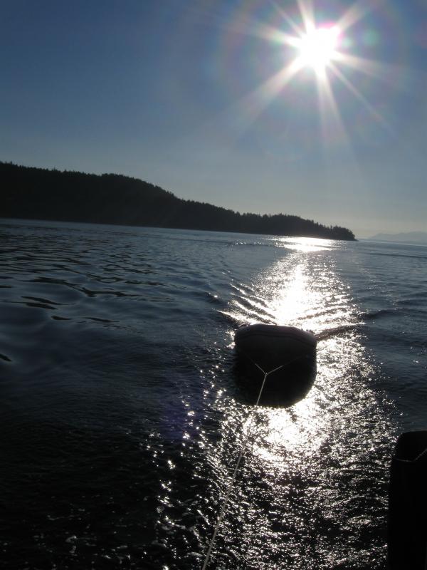

Your last statement is reality. The type of tender and towing method is definitely a tradeoff. I will be doing most of my sailing in coastal waters of the Pacific North West (ie south to Tacoma area, north to the top of Vancouver Island). The norm will be towing dinghy (Walker Bay Odyssey 270 - air floor). A small 2.5 HP Yamaha, normally stored on the Hunter stern rail, powers it. If the weather forecast is to be bumpy, I will secure dinghy on deck. I had the dealer rig a spinnaker line from the top of the mast to allow us to do this. Dinghy weighs in at only 63 lbs so it is very do able. Towing does add a drag on the sailboat but I find it to be minimal and possibly less than 0.5 kt when at cruising speed of 6.0. If we day sail, we normally leave dinghy at dockside. I am not a fan of davits as I find that the dinghy flops around more than I am comfortable with and I am not willing to give up my rear access to the cockpit. The latter is a major reason I purchased the new Hunter. Inflatables are not conducive to rowing and getting a 4 person one will mean a rather lengthy one. A RHIB will solve this problem with the addition of weight and inability to roll up for winter storage.
Coming alongside is usually not a problem as you will know beforehand which side you will tie to. Dinghy is then brought and secured close in, on the opposite side. Towing line brought onboard so not to get tangled in the prop/rudder.
