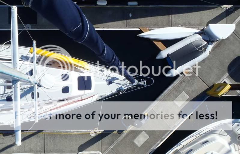

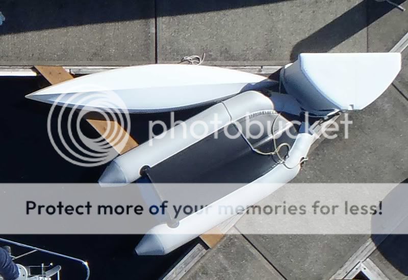

... if you can get permission you might try a dinghy support. At my private condo marina the ONLY thing we can attach to our docks (old stuff was grandfathered) is a treated 2x12 to use to pull the dinghy up on. We can't have anything that impedes on the concrete floats so everyone in the marina does this to store dinghies and kayaks. Here are two shots of mine.
View from the mast:
Close up.
The 2x12 has a 2x6 that is screwed on the underside down the middle for support, but the 2x12 is only attached to the dock with 4 nails, two on each end. Easy to remove, doesn't damage the dock, and easy to get the dinghy out of the water.

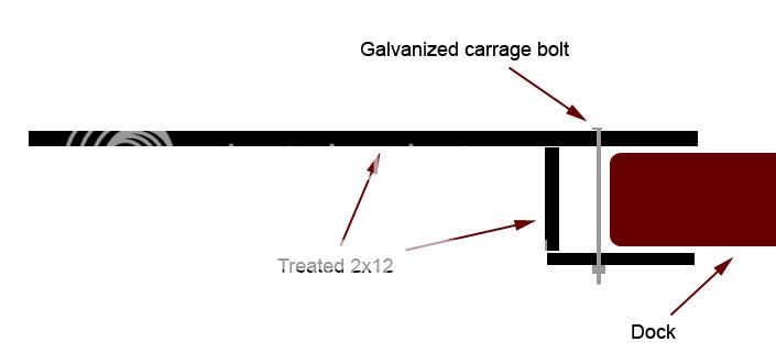

If you can't attach anything to the dock, you might be able to create a simple clamp out of treated lumber that would clamp each end to the dock. Maybe something like this:
Maybe none of the above would work but the advantage to a 2x12 is that it is cheap, easy to transport and dispose of and everything is out of the water (otherwise your float just starts to grow stuff).
