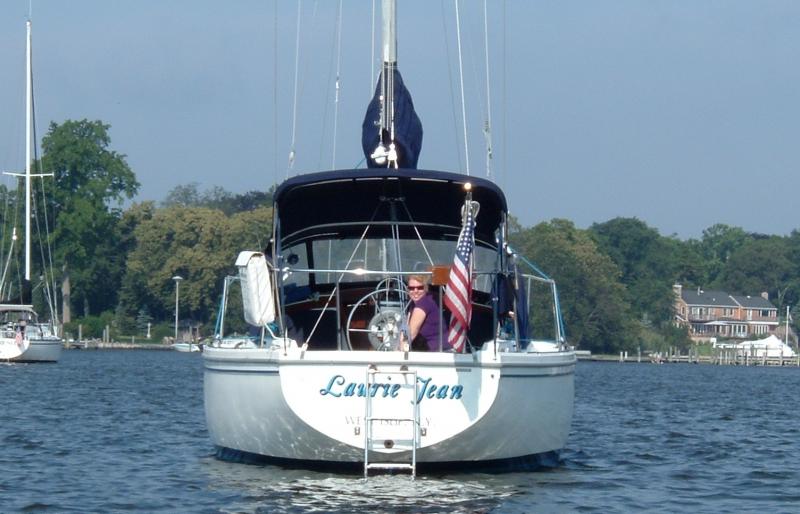

We hang our little 3.3 Mercury on the stern rail behind the perch seat, on the side where the bow of the dinghy is when hanging in the davits. Our dinghy is a Walker Bay 8, so we have more room to do this than you do. I don't know if you can tilt your outboard up when it is on the stern rail. Ideally, you want the dinghy high and tight to the davits. The dink would most likely be as high as the stern rail.
We only leave the outboard on the dinghy when we are anchored overnight, and are hanging the dinghy for security and to let it dry out. I agree about hanging the engine on the side rail. It would definitely attract pilings. This is a worthwhile project that you will really appreciate.

Thanks Tom, wow the stern of your C31 looks completely different from my old '77 C30.
