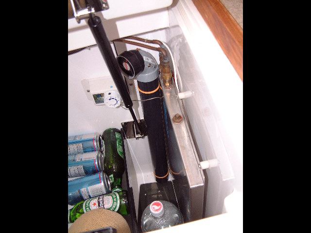

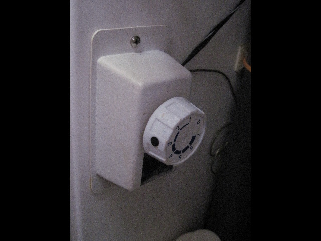

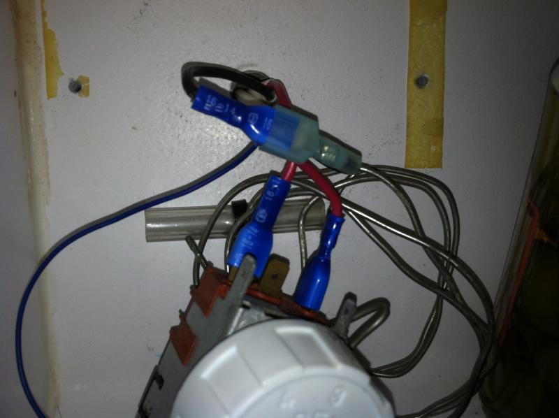

Many with spill over refrigerators have been fighting temperature control for years.
Finally have working system on my 2001 Hunter 410.
Years ago I used window foam around all opens of Freezer/Fridge. This helped build-up of ice tremendously.

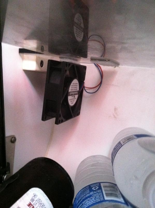

In order to get even cooling in fridge, I installed a 12 volt computer fan (under shelf) on the hot side of thermostat so that it runs continuously with the fridge breaker on. This solved the uneven cooling in the box.

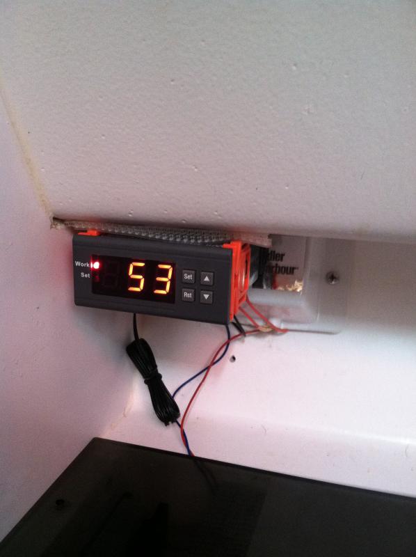

I just finished installing a digital thermostat (EBAY ~$19.00). What a difference. Box actually stays around 38 degrees. Able to open box and immediately see actual temperature.
