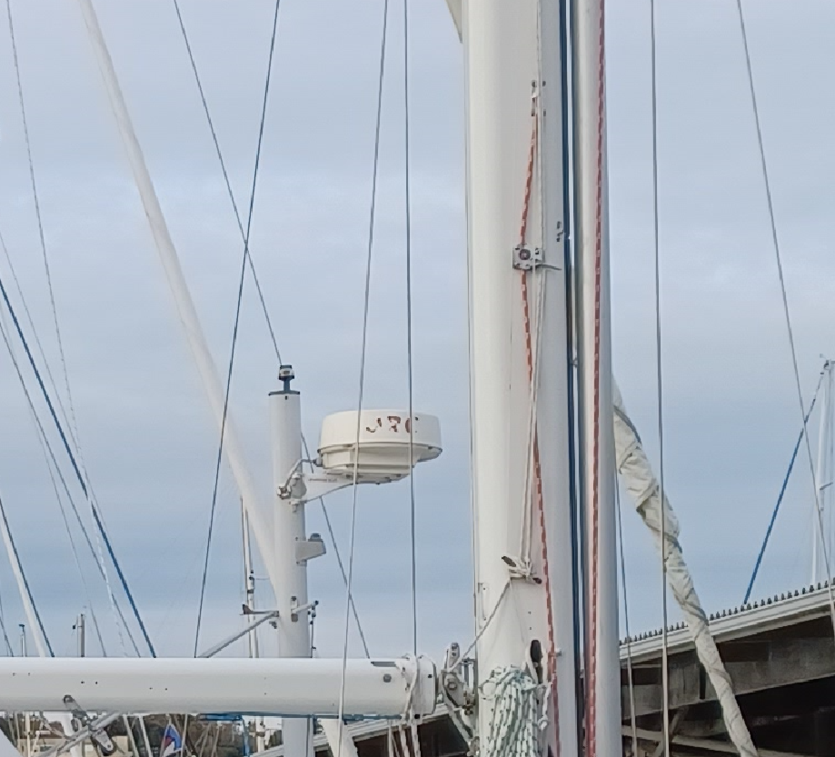

From Ward H: "...I’ve always thought the mast exit block added the most friction to turn the halyards towards the cockpit. No BBs and small sheaves add up to a lot of friction. At least the deck turning block has larger sheaves with BBs. I often have wondered if adding a mast exit plate for the main halyard and a 2 or 2.5” sheave BB block at the mast base would be a better way to go than the current mast exit block. ..."
I also would prefer this setup to my current one of having the halyards exiting the base of the mast through a block at 90 degrees .
It has less friction and gives you the option of jumping the halyards at the mast.
There is a YouTuber Christian Williams who sails Erickson's. His boat has this setup.
The halyard exits the mast about six feet above the deck then is led aft to the cockpit/winch through a BB turning bock.
He added a "jam cleat" (clam cleat?) to the mast about 2-3 feet below where the halyards exit the mast.
He raises the sail then jams the halyard in the cleat and walks back to the cockpit.
When he winches in from the cockpit the line pops out of the cleat and he now controls the line from the cockpit.
l like his videos. He is a retired screen writer (Hill Street Blues TV show..)
He also has some books which are fun reads.
Cheers
Cheers
I have already done this with my spinnaker, and it works great. Just need to bite the bullet and do it to the main as well.
