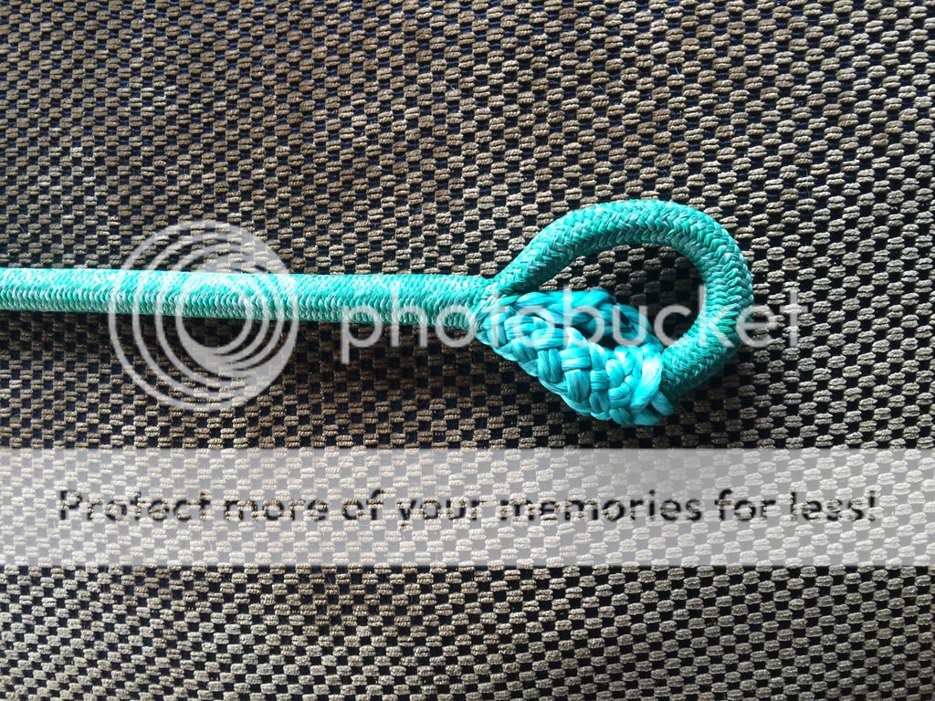

I talked to another Rigger and asked about the situation, he actually recommended slicing the cover at the throat and then whipping it. Not so sure about that... I might want to give it a go with a winch before I try that.
Finally uploaded a picture... Just so you can see what I'm working with;

I had that happen with some eyes. That's when I followed the Samsons video. I held a small tube in the eye and snapped/jerked it tight until that core pulled inside. The steady pull wouldn't work. I also wet the eye and added a little Dawn on the core to lube it. Worked for me.

Got stuck like that once. Nothing worked. Pulled the knot out and started over... Found I had missed a step. Like the unkinking of the first part of the Brummel.
That was also my first attempt to rectify the situation. I double checked for kinks or cross overs and also carefully made the tapering as fine as possible.
I still haven't tried a proper winch set up on a bench. I was planning to build a nice work bench from reclaimed materials so I could bolt a used winch to the far end of the table. There was a guy who put some used Butcher Block Kitchen counter tops on Craigslist for $75, but he never answered my emails because I'm sure they went right to his junk folder!
Anyway, I already have a 10 foot Bench in my garage/shop but I'd have to relocate my bench-top tool boxes. Either way, at some point I'll create a proper splicing bench with a proper winch. When I'm ready I'll try the dish-soap lube method that All U Get suggested along with hammer-setting and winching... If all that fails I'll try slicing the cover just a hair and whipping it. If I hate it or it seems unsafe, I'll cut off the whole thing and do the cover-less splice again shown it the first picture since I know it works.
