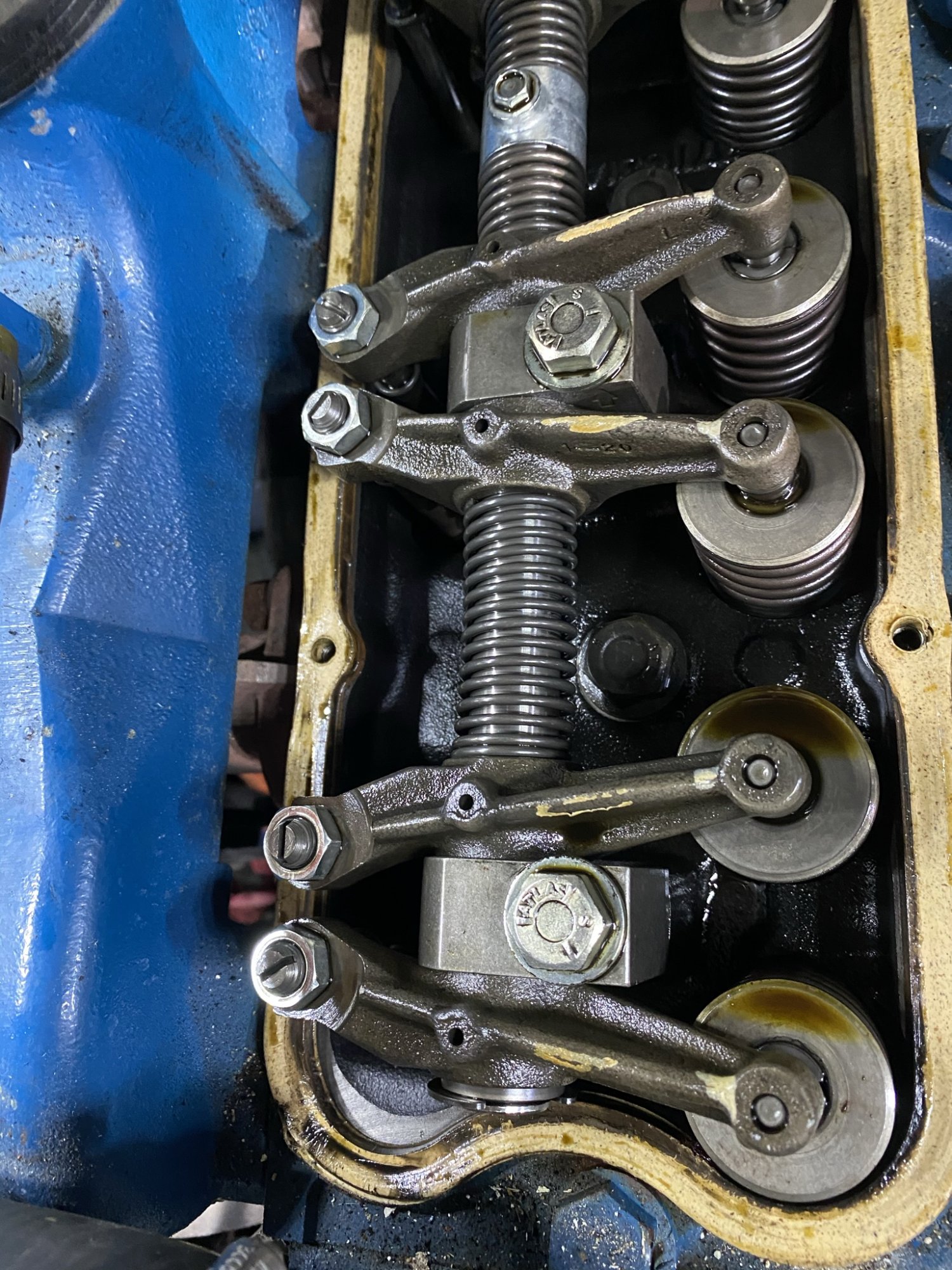

I was going through some maintenance items and wanted to check the valve clearances on our Perkins 4.236. Several valves have more than the 0.012 in clearance so I thought it would be easy to adjust. However, I found the locking nut to be tighter than I can turn with an 8 inch box wrench. Should I use a breaker bar, pipe extension, or some other means to loosen those nuts? We’ve never had any adjustments checked since 2011.

I don’t think I can get a wrench between the arms to hold one in place.

Hi Tom, a simple Google search with the caption: Adjusting valves on Perkins 4-236 brought a lot of info, among which the attached. I understand why you can't put a wrench between the arms, but as in the attached picture you could use a heavy flat blade screwdriver. Holding it with Vise-grips should provide enough holding power for you to unscrew the nut after you've let the PB blaster do its job. If screwdriver has a square shank you could even use a small open-end wrench on it. Hope it helps.

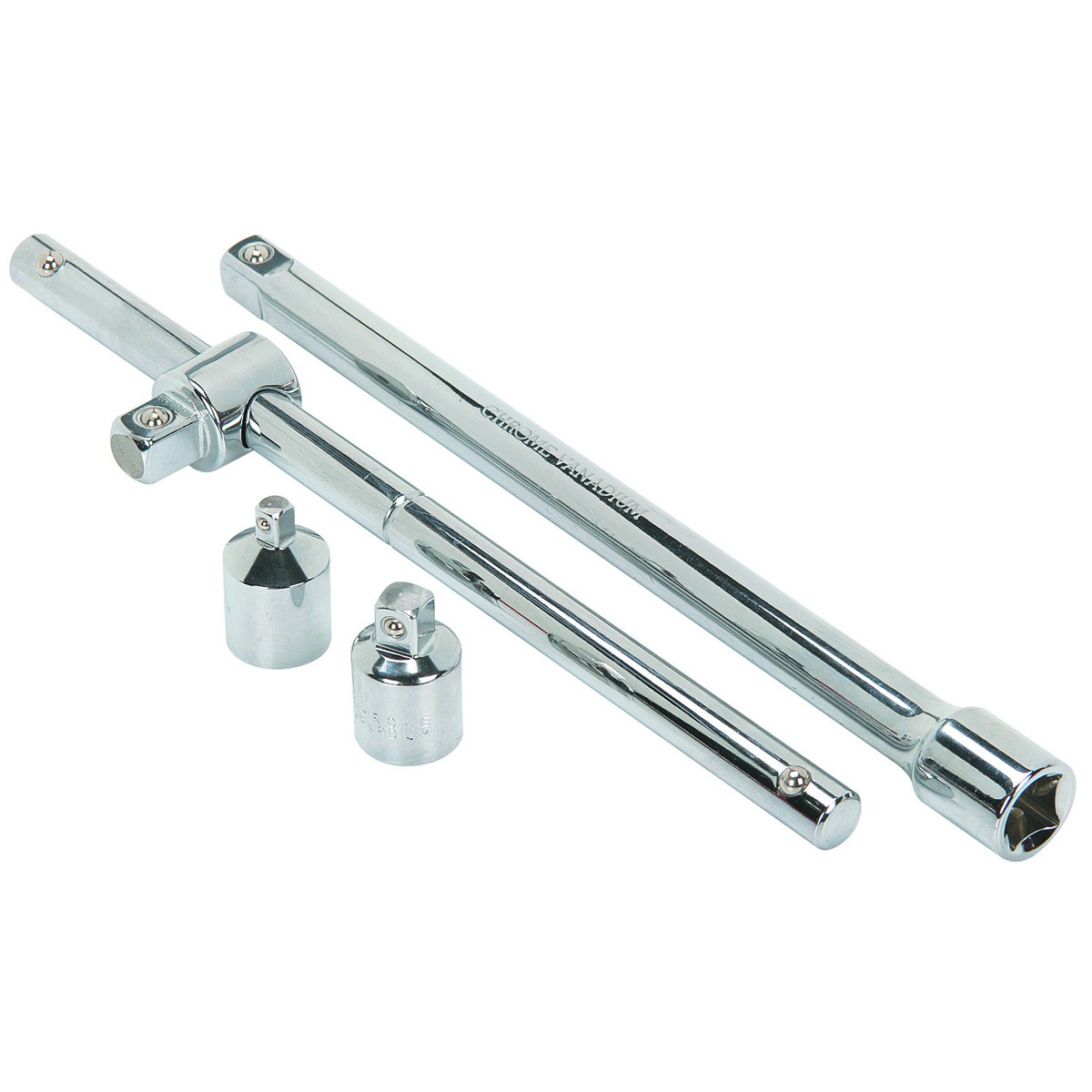

How about a T-handle socket wrench? Should balance out the load on both sides but give the torque you may need. Available at Harbor Freight.
Not quite sure what you mean. Excessive torque applied to the lock nut is the issue as it could bend the arm. Unless I misunderstand, whether that torque is applied from one or both sides of the socket doesn't make a difference to the rocker arm.

I have been working on engines professionally for over 40 years and have adjusted many valves just like the ones you show in the picture and those nuts can be very hard to break loose. The reason these nuts are so tight is that they are machined to much tighter tolerances than your typical nuts and bolts. This higher quality machining causes the threads to match much closer making them have more contact between the threads. Forming threads in this way allows the absence of lock washers without the fear of the fastener loosening. You can really crank on those nuts with no fear of bending or breaking the rocker arm. It is typical to hear a fairly loud cracking noise when they break loose which is nothing to worry about. If you can't get them loose with a wrench an impact gun should work. It is important that these nuts are tight after adjustment and you must recheck valve clearance afterward as the adjustment will change when you tighten the locknuts.
