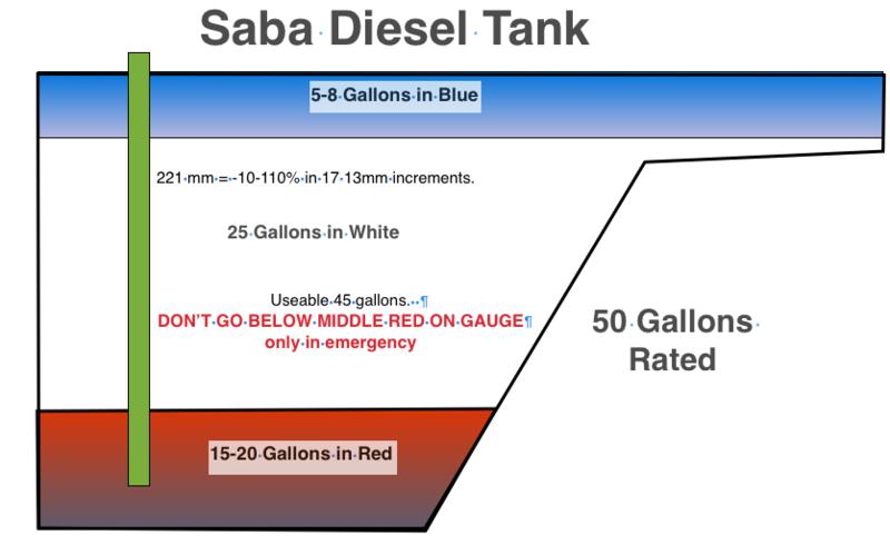

I just recently replaced my level transmitter with its modern day exact version.
http://www.wemausa.com/sensors/level-FuelWater.shtml#.VcvvLXjTQo8
It cost me <$50. I also downloaded my exact fuel tank design from Hunter's website.
The SSS/SSL is 220mm long and reads in 13mm increments. That similar to a foot long ruler reading marked only by 3/4" marks only. No way to read 1/4th inch so you MUST work with that precision.
Shown in my picture is a rough drawing of my 50 gallon tank. Note how I use it, but it still works when checked on each fill and verified by fuel logging.
Your fuel gauge is as much a SAFETY device as a PFD. Get yours working and develop confidence in it telling you information.
This simple pictogram of my tank..
1) Green rod is my sensor ( note that it not on bottom )
2) It is not linear with tank percentage. LOL neither is the tank shape.
3) My 50 gallon tank is really 40 and 5 gallons is kept separately to compensate for Time/Distance variations.
4) Saba is my boat name :) , not a scientific term.
5) This is posted near my gauge.
It doesn't take much effort to do the same calibration and service your fuel gauge.
Jim...
