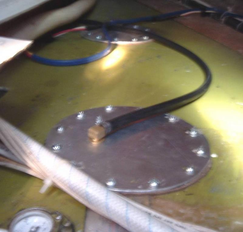

After going thru three filters on the way up, we I had to be towed into St.Pete costing $1,000 bucks (thank goodness it wasn't my boat and thank goodness for SeaTow), Learning from his lesson, I felt around by pushing down on my tank and looking thru the fuel gauge, and then cut three access holes in the tank. GLAD I did, it was nasty with all sorts of stuff. I was able to clean every crack, then went shopping. I found some aluminum stock that I cut out for plates, then drilled and tapped a whole bunch of threads. I probably went over board with screws, but not by much. I used some fuel proof rubber from Goodyear and I can say that after 5 years, everything has worked really well. If you want to cut the tank out, it envolves flying fiberglass in a confined space, and you then still have to get into it once it's removed. Once last tidbit that has really saved my ass out there, was the previous owner put in an electric fuel pump right after the lift pump, I recommend one. I did have pics, if I find them, I'll post them. Better safe than sorry, It's best to know exactly what's going on regarding what's in your fuel tank, because when it messes up, it'lll probably be a moment when you really need your engine to work. Really, think about it, big wind, then big waves/current, shakes up tank, kills motor, which is needed to stay safely in the cut fighting the breakwater, etc.

I'm on the fence with this idea of removing the tank. My boat was twenty years old when I cut access holes to clean the tank. There was almost nothing in there worth the effort. Other people find lots of crap. I would suggest one access hole of about 8" where you can see the fuel pickup. If there is a lot of gunk there at the lowest point in the tank then maybe make the decision.

Hey Jack I have a stainless tank same situation, removing is not an option right now, how did u cut the holes. I may be able to get a right angle drill in there, not a lot of height there. Can I purchase SS circular plates to cove after?>>>Red

My tank is aluminum and I had easy access to the top of of the tank. I marked where I wanted the holes and used a jig saw to cut them. Cleaning the aluminum chips out of the tank was a pain. Cutting stainless will be more difficult especially without good access. As you suggest an angle drill with a hole saw might be the answer. Removing the tank might be a better choice in your situation.
Ed
I didn't find much gunk in the tank but I had just bought the boat and wasn't confident that the PO had taken measures to minimize algae growth. I know now I have a relatively clean tank.
