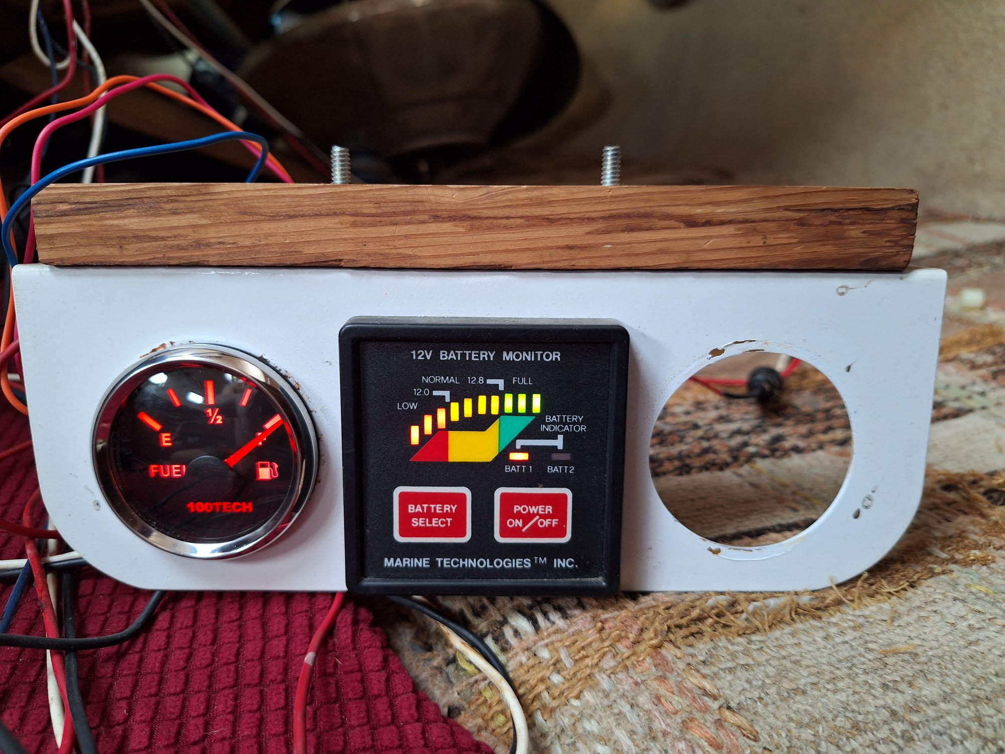

I've verified I have a faulty fuel gauge. I'd like to replace the sending unit and fuel gauge together. Does anyone have a recommendation on which parts to buy?

Thanks Dalliance! I pulled the sending unit today and tested it. Very inconsistent ohm readings, so I ordered a new sending unit plus a matching fuel gauge from Amazon. I'll install it this weekend after testing it first.

Installed a new sending unit and fuel gauge I purchased from Amazon (links below). Works great! Now I have to fix/replace the hour meter.
Fyi, the sending unit varies based on the depth of the fuel tank. My tank needed an 8" length, but yours may be different.
