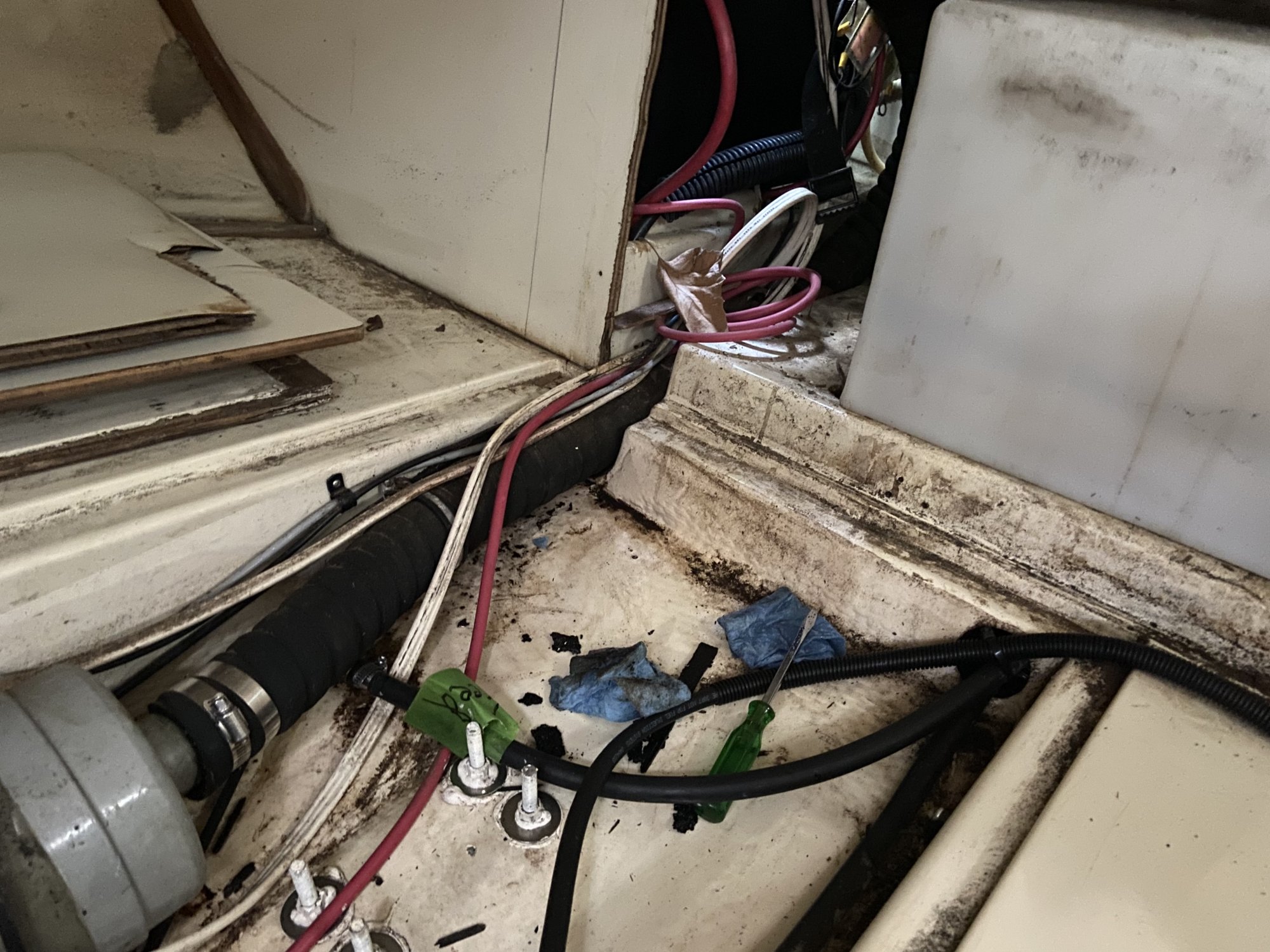

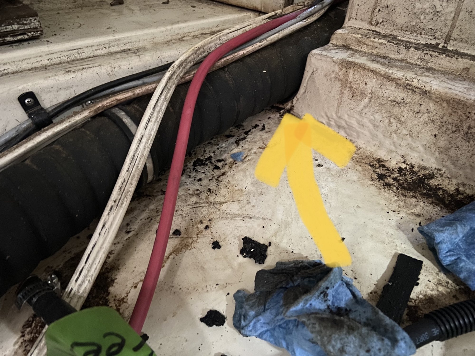

I can’t find the source of my diesel leak. It’s dripping when the motor is running. Coming from aft cabin space dripping forward under exhaust pipe. I can’t access the fittings on tank and tank is full of diesel. Any ideas??
