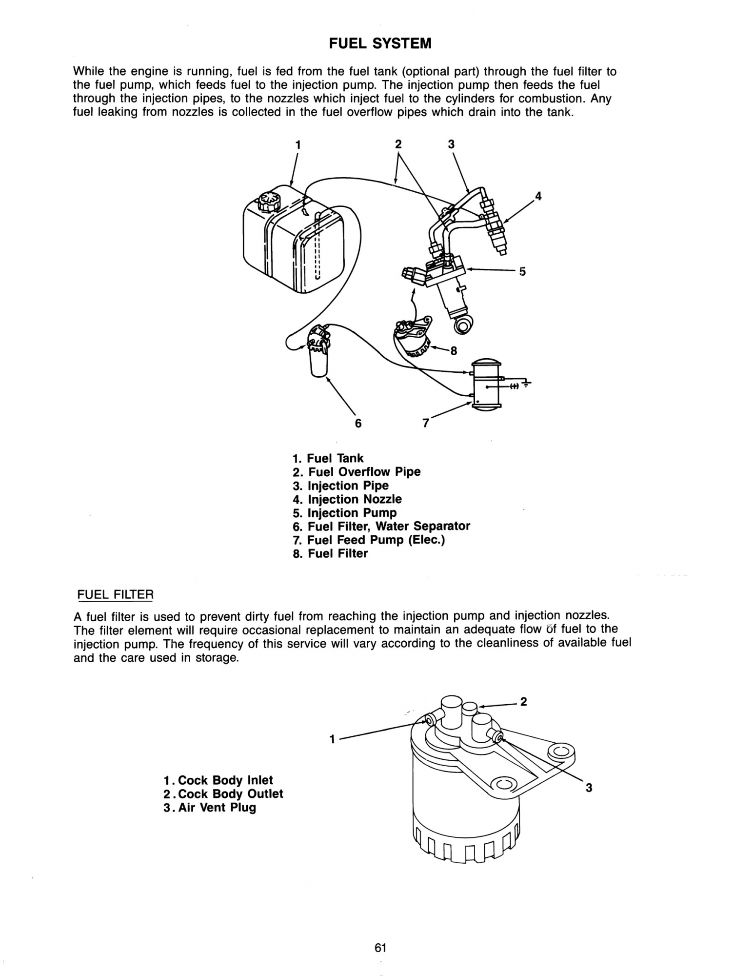

Thanks! How would I identify that return line?
If it a Universal diesel it would be the #2 line on this diagram, from the engine back to the fuel tank. The description says "pipe" but it is most often what you might call hose
Not to be confused with the fuel line from the tank to the engine which in the diagram first goes through items 6, 7 and 8 before going to the injection pump.

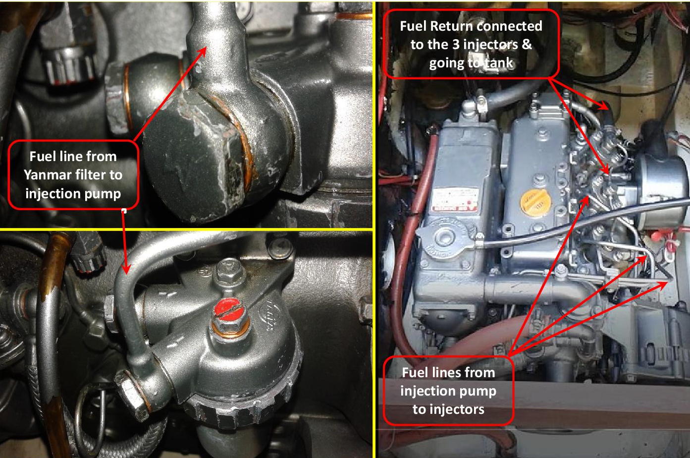

Yes, the high pressure line goes into the top of the individual injector and the return line comes from lower down on the injector and is usually ganged together with the other injector return lines; usually transitions from metal at the injector to a rubber fuel hose as it leaves the last injector heading to the fuel tank.
Dec 14, 2003
1,450
A few days late but you can keep the attached for future used. Don't recall if I made that pix myself or got it here on HOW, but on it you'll see what Kloudie is talking about where the rubber fuel hose return line attaches to the steel pipe after the 3rd injector
