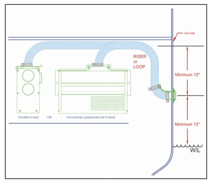

Reviving this thread. I am planning an install of a ITR SCH33 hydronic diesel heater. I'm wondering if anyone has had any issues with water ingress, especially when heeling, with an after quarter mount?
23,843

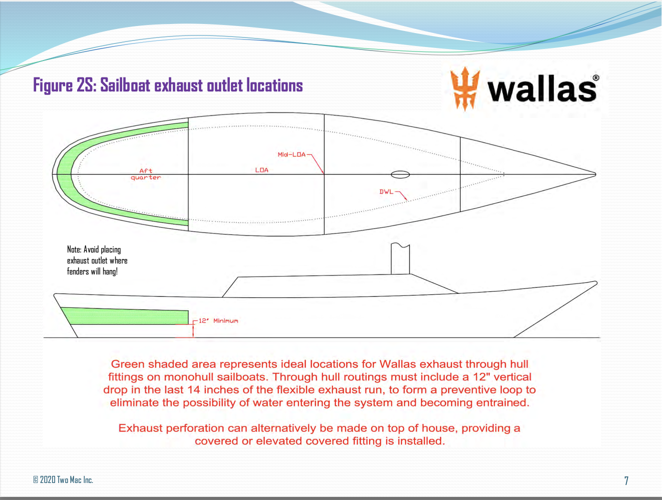

I have a forced air Wallas diesel heater on my boat. The basic concept for installing the exhaust pipe is common.
  1. Locate the exhaust port in the stern quarter to vent the exhaust and reduce the possibility of it being sucked back onto the boat.
  2. Locate the exhaust port above the water line
  3. Be sure to provide a 12” tall loop in the exhaust hose/pipe above the exhaust port. This is to minimize the potential for water to flow up the pipe and into the boat
I installed my system based on these principles. I have not had water ingress in the heater exhaust system either while sailing or motoring during a high sea state.
Here is an image of the system diagram.
