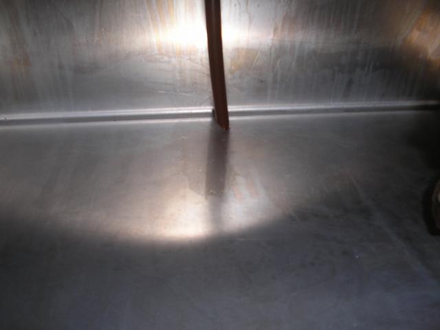

Rich,
I cut an access hole last season to see what was inside. I was surprised how clean it was. The tube was cut at an angle and went right to the bottom.
