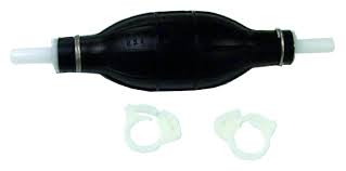

At this stage in the game, Stu's idea is the only way you're about to find the leak. Try installing a hand operated OB engine primer bulb as close to the fuel tank as possible and then pressurize and go through with a wiping rag checking for leaking fuel.
Still no leaks ? ? ? ..................... it's got to be inside the fuel tank.
