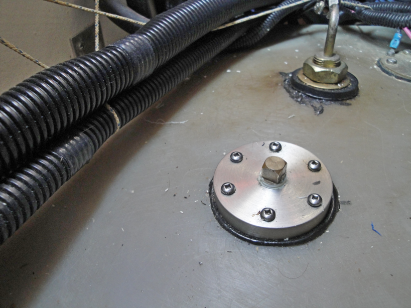

Maybe back up to a little before you first paragraph. If you don't have an inspection port, you could install one of the add on devices on the top of the tank. That wouldn't be my first choice however as diesel has a terrible history of leaking on gasketed surfaces. What I did install was a small SS disk with a 3/8" NPT plug and the usual telon tape and thin layer of Permatex #2 sealant on the plug which I've never seen leak yet:
The stuff oozing out of the underside of the SS disk is a good dose of Permatex #2.
Every couple of years I'll pull the 3/8" plug and run a small tube from my Pelor vacuum oil pump down into the bottom of the diesel tank and pull a long continuous sample. The small vacuum tube comes up through a short length of clear 1/2" vinyl tube and I check for crud in the fuel as it slowly goes through the larger dia. vinyl tube. I keep dragging the tip of the tube along the bottom of the tank checking for algae. The small Pelor tube has a thin piece of spring wire in it to guide it to where you want it to go. I have not seen a sign of algae in 27 years nor a trace of dirt in my primary filter after a change.
Maybe the lack of dirt is from clean living, or the BioborJF that goes in after every fuel fill up ? ? ?
