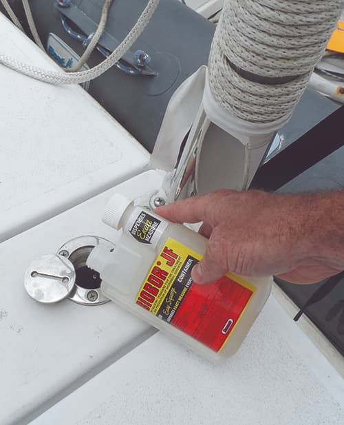

I have a small 19 gallon diesel tank and that can last me a season here on the Great Lakes. As you can see, I am not refilling the tank very often. I usually top the tank off in the fall before haulout, and add a bit of Biobor Jr. to keep any growth in the tank at bay. I don't add anything else.
Practical Sailor had an article that discussed various additives…
