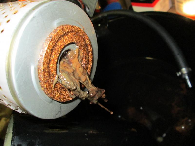

The good news is that the fuel I removed from the secondary filter looked pristine.

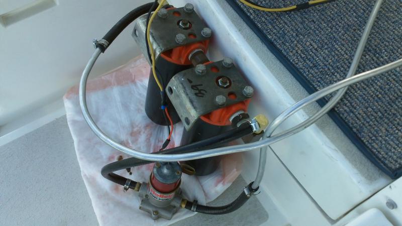

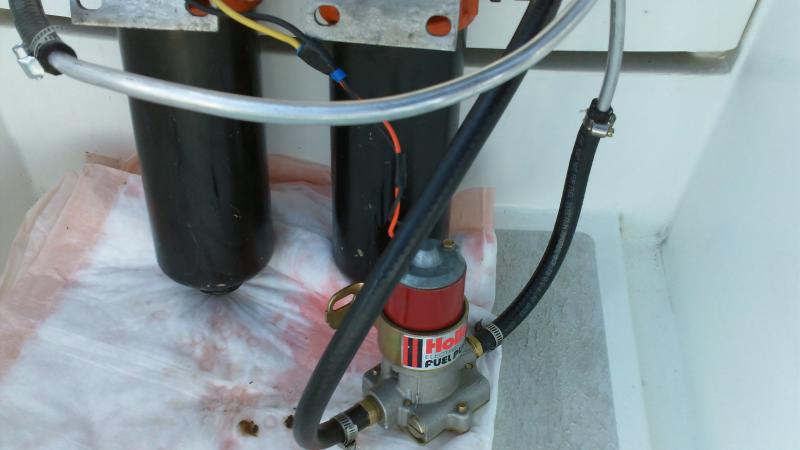

I'll have to think on this. I can certainly rig something along the lines of what Rich S. suggested to circulate the fuel continuously for whatever time is necessary.

The filter I have is a large, high capacity marine dual cannister filter. I am going to use Baldwin filters which are made both in the USA and in China, but within their own factory, not outsourced. I got the micron specs directly from their engineering department. Baldwin PF942 & PF943. I really don't know what else to do.
