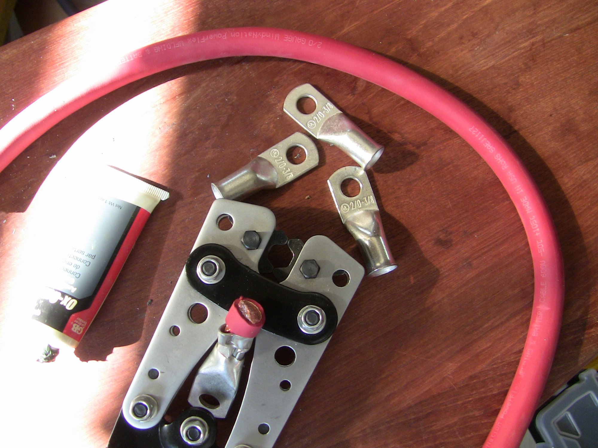

This what we used for 2/0 wire.
note the Anti Ox and first error.
We got it right the 2nd time.
Jim...
PS: Under the Arm type Crimper.
