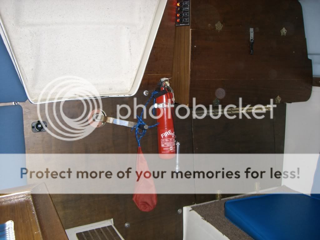

I have a "76 Venture (Mac) 25 and the winch is not in the cockpit nor on the floor. As you step into the cabin there is a "step" formed in the fiberglass liner. The winch is bolted to the underside of the step and the handle protrudes into the cabin. As to the original winch - not sure of weight rating, but I replaced mine with a 1500# model from Northern Tool.

Speaking specifically about the Macgregor 25, (which I used to own), the stock winch was bolted to the underside of the galley/cockpit hatchway. This placed all the weight of the keel on the cockpit floor. Supporting the weight however, was a wooden panel wedged between the lower companionway sill or step and the floor of the boat. A hole was bored through this board for the winch handle. If you dared to remove this board (you'd have to kick it out) after unbolting it because of the weight it was supporting; it would either collapse the cockpit floor or rip out the winch, due of course to the keel hanging from it.
When relocating the winch, it would simply be placed directly below where it originally hangs. However just relocating the winch would not be practical on its own because then, it would not be servicable in the sense that you could not crank the handle because there would be no 'swing' space for handle rotation. Hence the idea of using an electric winch instead. The electric winch could be mounted on the floor over the keel cable hole where the best lifting advantage is.
I don't know of anyone who has actually done this, but I gave it a lot of consideration before selling my Macgregor 25 for a purchase on a Magregor 26M. Had I not sold her, I believe I would have made this modification happen. The main reason for me was, I wanted to remove the wooden panel so that I would have greater access to the space beneath the cockpit and also to get rid of that 'ankle biting' winch handle. !!!!
