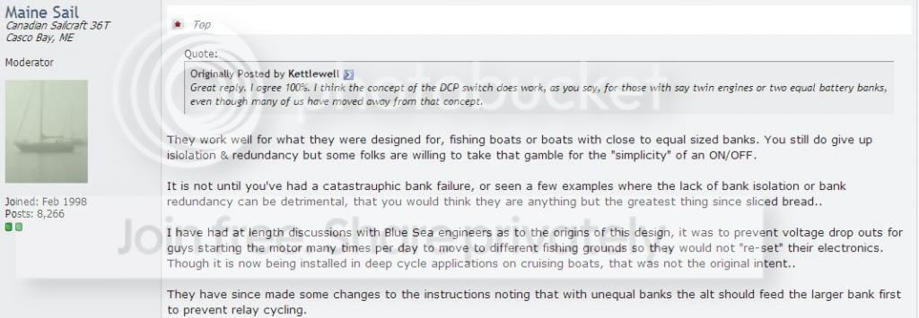

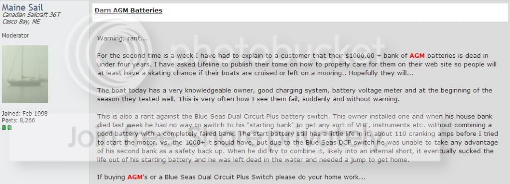

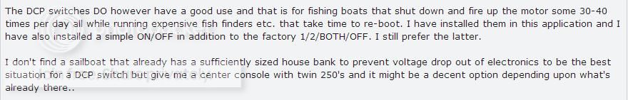

Mitiempo says that DCP is for small boats where each bank is small and equal. That's not the case. I use it exactly how it is intended. I have 200ah deep cycle using 2 batteries on main bank and a start batt on start bank.
Below are posts by Mainesail concerning the Dual Circuit switch.

Thanks for that, mitiempo, I remember reading those issues so I have wired my alternator output to the house bank. I also would not combine the start batt if I had a dead house bank ... there is no need to. I've never experienced an internal short, and never heard of one either. I don't worry about a lot of things that maybe I should. I often wonder how I ever survived! :confused:
