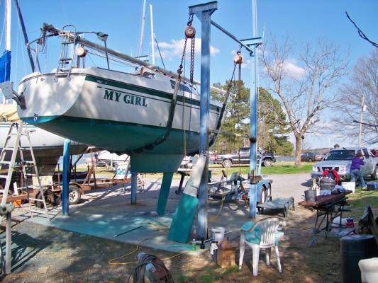

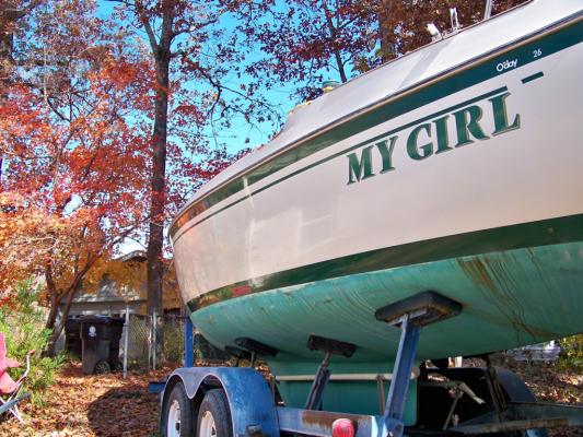

Well I got bad BOAT news today. She is a 1984 O'Day 222. I took my girl to Little Rock toady for maintenance and repair. One of the things I had thought about was to have her professionally painted. The minimum was to have the bottom painted. I was shown where the last bottom paint job was applied over the previous bottom coat by the prior owner. It hid the fact that the gel coat below the water line is blistering, cracking and flaking off. In places you could see the fiberglass on the hull. Not happy... I like every thing prefect. The owner of the shop is an experience and knowledgeable sailor... his suggestion was to sail the boat like she is... and pull her out of the slip and power spray her a couple times a year to keep the bottom from fouling. Suggestions?

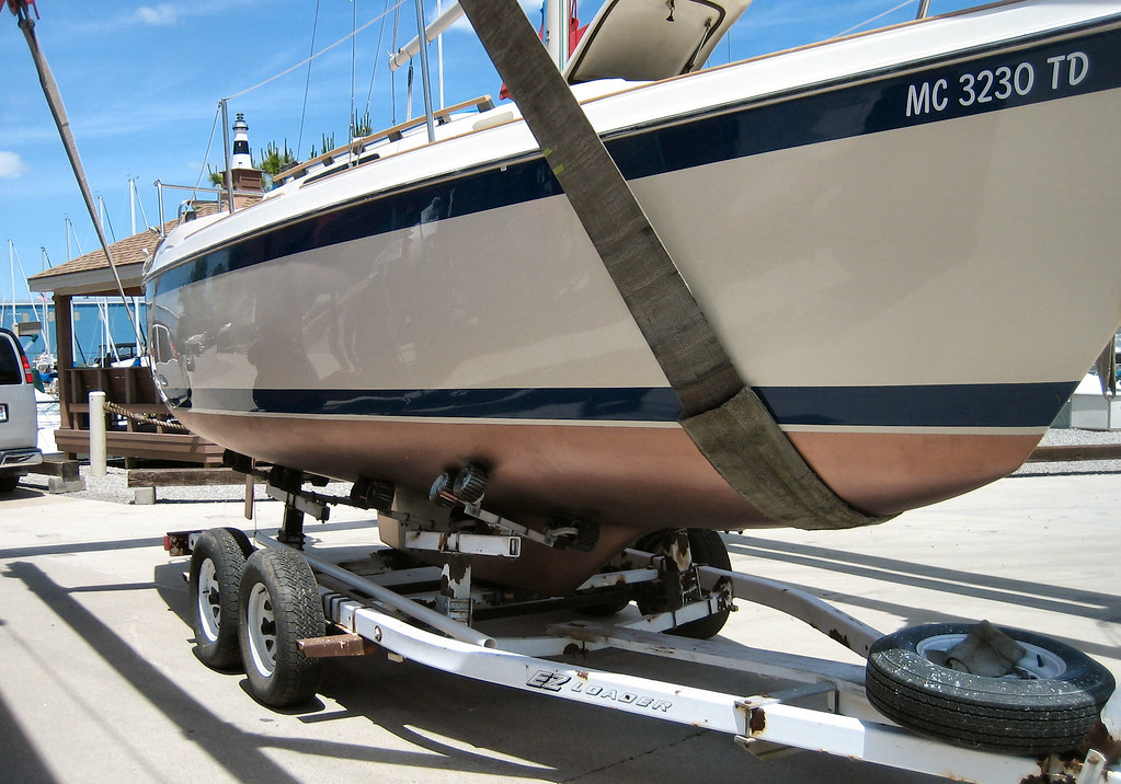

If the topsides are in good shape and just oxidized why don't you consider wet sanding and polishing the hull. Fairly easy, goes quicker than what you think it would and almost foolproof. I did it. Keith did it. and there's plenty of info here on doing it. A lot cheaper than painting.
Here's what my 83 Oday looked like when I splashed her last year after a two year rebuild.

Ok rich, but shards out this shine?

Hey RBone. How about getting over on 'And so it begins' thread and posting your technique for sanding and polishing. That is exactly the outcome I'm looking for with YOT. What buffer speed, pads, compound(s) etc? And post that picture of the boat on the trailer, that is gorgeous.
