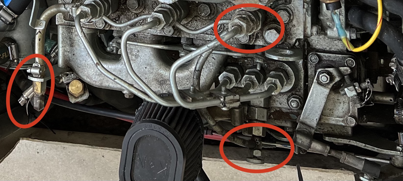

Hi,
My 1984 C30 has a universal M25 that won't start. It cranks just fine. Steps I've taken so far: replace secondary fuel filter, bleed fuel lines (at secondary filter and at bleed screw just proximal to the injector pump), confirm starter is receiving charge. I unscrewed the injectors and did not observe any fuel spurts when the key was turned & fuel pump engaged. To my understanding this isolates the issue to the injector pump. Does this diagnosis sound correct? Is there anything else I should consider?
Many thanks!
Dave

High Dave...
It is a challenge. You need to start somewhere with a fuel issue. Your engine is supposed to be self priming. Till it isn't.
Sounds like you want to start at the injector pump. Test to see if you have fuel to the Injector pump. Try loosening the fuel line that supplies fuel to the Injector Pump.. Turn on the electric fuel pump. If fuel squirts from the line then you know you have fuel to the injector pump... It could be that air is trapped in the injector pump. You need to bleed the injector pump. Your manual should tell you how. Basically it is opening the bleed screws tilll fuel flows to the injectors.
If no fuel leaks from the line you loosened, then the problem is between that point and the fuel tank. You need to work your way back from there to the tank to find where it is fouled.
Good luck. Be methodical One step at a time.

This is the bleed screw on my M25XP. It should bleed any air out of the injector pump. Is yours the same?
This doesn't sound like you cranked the engine, just turned on the ignition to let the pump run. Doesn't the engine need to be cranked for the injector pump to pump fuel?
Thanks Ward. That's exactly what I got from the OP's description of what he did to clear any air from the injector pump. The injector pump will only turn over if the engine is turning over and from what I understand, the engine wasn't turning over, only the electric lift pump.
To bleed the injector pump of air, you must have someone crank the engine while you crack an injector fitting (or open a bleed screw as per @Ward H) to reduce the back pressure acting against the injector pump and allow air to be forced out of the pump.

Agree with all above. Had similar issues with my C30. You can temporarily use a piece of clear tubing in the fuel line feed up to the engine. The clear tubing lets you see if any air is getting in the suction. I also had to remove the injectors from the engine (still connected to fuel) and crank the engine till I saw fuel spray. Even though I had cracked the fuel line on top if the injector and was getting fuel, I still couldn't start. If you remove the injector, you may need to replace the copper crush washer. After you are all done, check the well around the injector for leakage.
