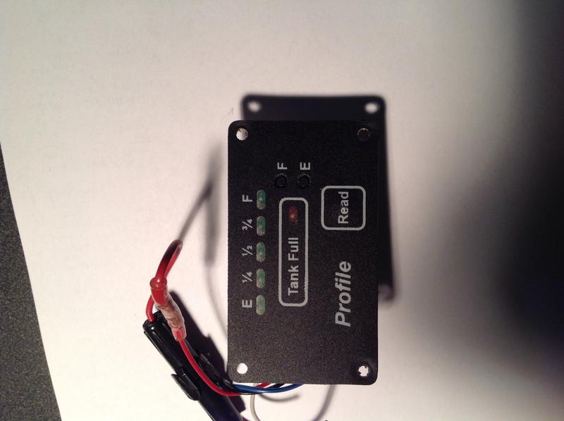

I happen to have a nearly new Profile holding tank monitor sitting on the shelf, that I removed from my boat last fall to replace with a multi-channel monitor (it was the OEM install on my C355 - see photo). This is the monitor recommended by Peggie Hall and that received high marks from Practical Sailor. I'd be willing to part with it for a reasonable price - PM me if interested. You would need the tank sensor and foil strips, which are available from Sailors Solutions for $38, as well as other suppliers. This is an external mount, and works quite well.
