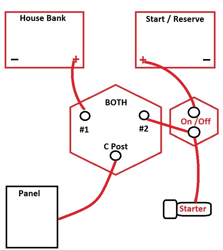

If you want all of the info regarding wiring Starter Motor and Alternator here is a great resource from our resident wizard...
https://forums.sailboatowners.com/index.php?threads/1-both-2-off-switches-thoughts-musings.137615/
155636682.jpg for the starter to a starter battery.
You will see in the MaineSail threads that alternators are best wired to the battery. as in this image.
How you manage the charging of batteries from the alternator is covered in volumes on this forum.

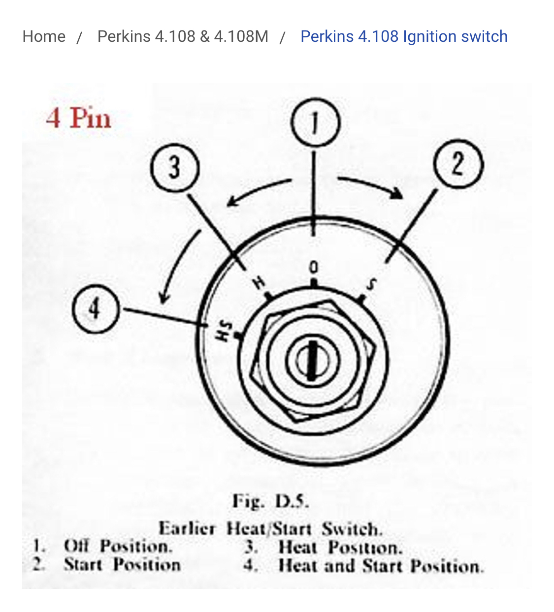

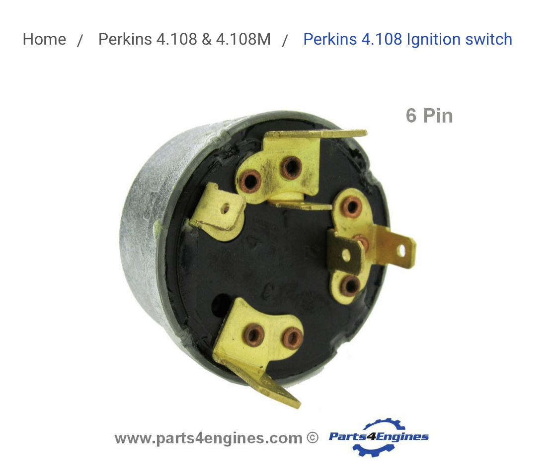

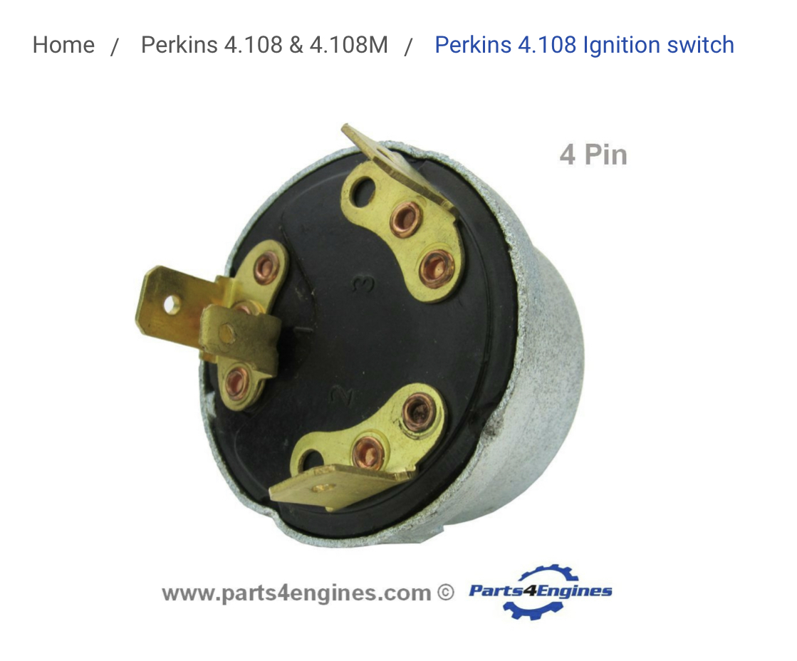

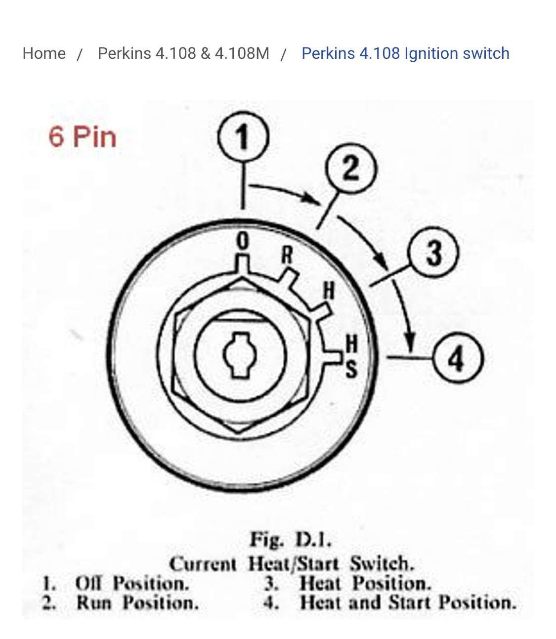

Hello, I did a big rookie mistake. I disconnected the wires to the ignition switch and did label them but the oil on wires let the tags fall off. I believe I have the original wiring harness. Can anyone tell me what color wires are supposed to be on which post? I have a 3 post switch. One says B, I, and S. After reading this forum, I now know the basic letters but there are several wires on a couple of posts. I found out how confusing wiring can be now. Hurt my back so crawling in the engine room looking at where the wires go is almost out of my ability (back). Any help is hugely appreciated! Mark 1977 Perkins 4108 in a 33 Morgan O.I.
23,860
Wiring depends on functioning of your engine. There is a 4 pin and a 6 pin.
Guessing is not a good idea when making electrical connections. You really need to identify the wires source connections. Colors can be changed over the years so even wiring from manual images can be suspicious.
Here are the functions for the two switch types.

Hope it helps you and your back.
